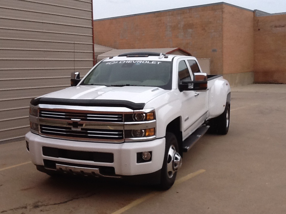

I agree my 3500 Srw rides considerably rougher then my buddies 2500 of the same year. But it rides much smoother then my Cummins ever did!0d85136b59c48c4d4cadf83e2a24905e.jpg But I don't regret doing it, my insurance and registration is cheaper then his 2500 and the missing tpms is nice since I plan on running over sized off road tires that won't hold 80psi. I did how ever trade rims and tires for a set of OEM 20's. Absolutely love this truck, and yes it has side air bags with the 10,800Gvwr. b0ddd86afe58edcde9e1b314332752dc.jpg
