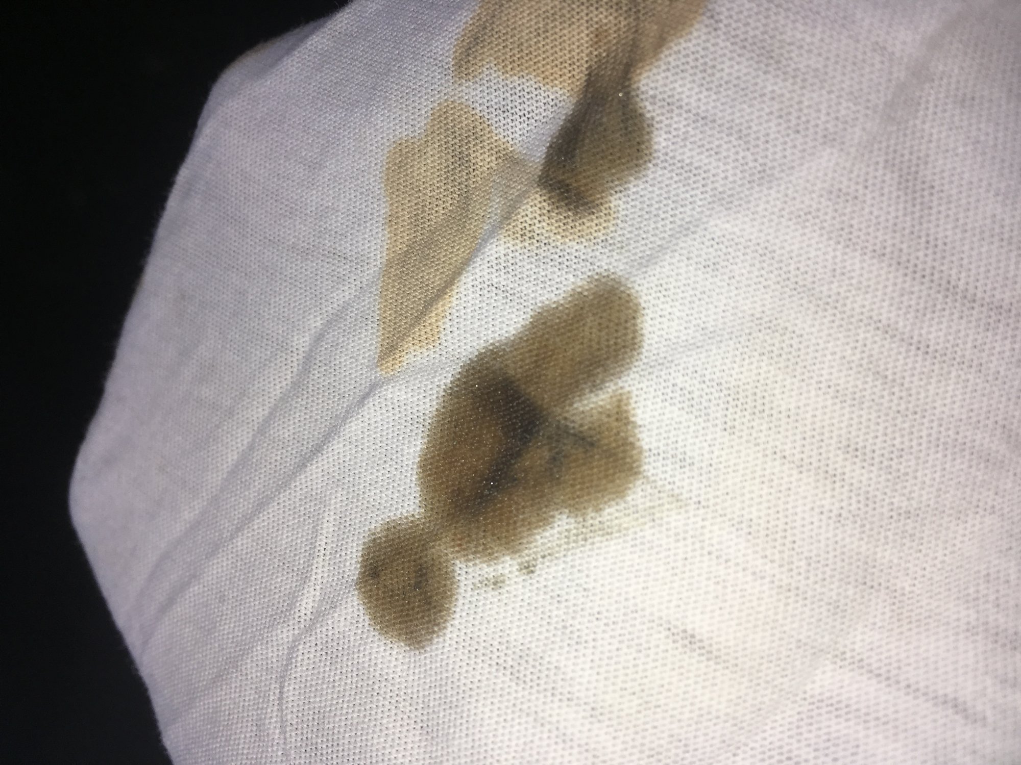

I wouldn't sweat it every vehicle has to break in and when you have metal on metal at those speeds and temperatures any imperfections are coming of I think they call it casting shavings or something shards that long could only come from your thrust bearing if something was malfunctioning anywhere else i.e. Bearings lifters valves everything else would be way smaller or shorter than that if anything was malfunctioning I'm super anal ocd adhd and that shit would drive me crazy till I had à one I trusted or at least a couple dozen people from the Internet tell me the same thing about it and then it would still be in the back of my mind looking at the pics I'd say she is breaking in just fine.
I have an 04 Tahoe 5.3 160k z71 murderers row black lol just kidding I just made that color up and named it after the 1927 new your Yankees line up haha anyway I've got the no oil pressure thing going on and when I pulled the pan to change the oring on the pickup tube discovered an enormous amount of very alarming size metal shards big ones like I've never seen metal like was in my engine in any other engine that was still running I immediately thought bearings but after inspections and replacement for no other reason than to waste money and discussion on here with Doug Scott and dirt they helped me come to the conclusion that all the ginormous shards in mine were casting shavings from break in evidence to help support this theory I had changes oil several times since I bought the vehicle 4 years ago before I pulled the pan I flushed the engine with seafoam in the crankcase ran it drained the oil and this was the first time I'd ever seen metal on my drain plug pulled the pan and really got worried but in the end granted I still don't have any oil pressure but I changed main and rod bearings oil pump pickup tube oring timing set all gaskets and seals anything that has to do with oil pressure it has a new part on it still no oil pressure but the point is that mine is 04 and still had to mongo shards in it why had I not seen it on the drain plug before just speculation but I'd imagine it was from running the sea foam and it broke the sludge in the pan up a little and that's how I'd never seen them before none the less from visual ll

I have a 2015 silverado ltz midnight edition 5.3 Z71 pulled dipstick today and seen many metal shavings 1/8 inch long and one about 1/4 inch long cleaned dipstick and then drove to work (bout 5 miles ) checked dip stick again and more shavings and another one was about 1/4 inch long wth truck only has 7k miles any ideas should I be freaking out seems like shavings are a little to large to me to be break in particles
