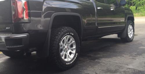

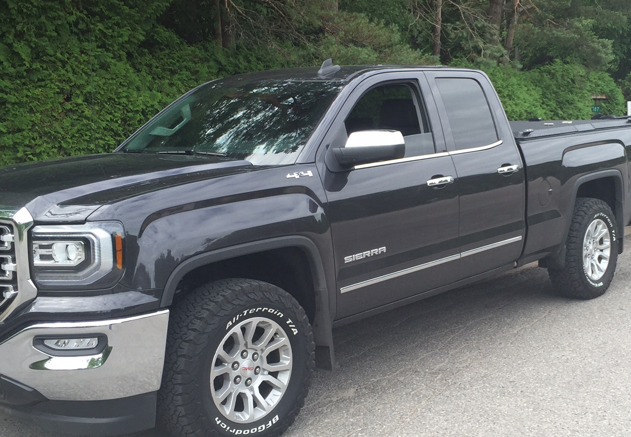

I went with 285/65/18 BFG KO2. Not to loud on the highway and not much bigger than stock. I can't comment on MPG because I had the dealership install them when I bought the truck. They are an LT tire so they will be a little stiffer than a P rated for ride quality. They are also winter rated which gets me 5% insurance discount where I live. Mine fit without a level so you won't have a problem.
