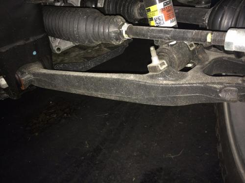

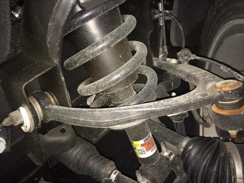

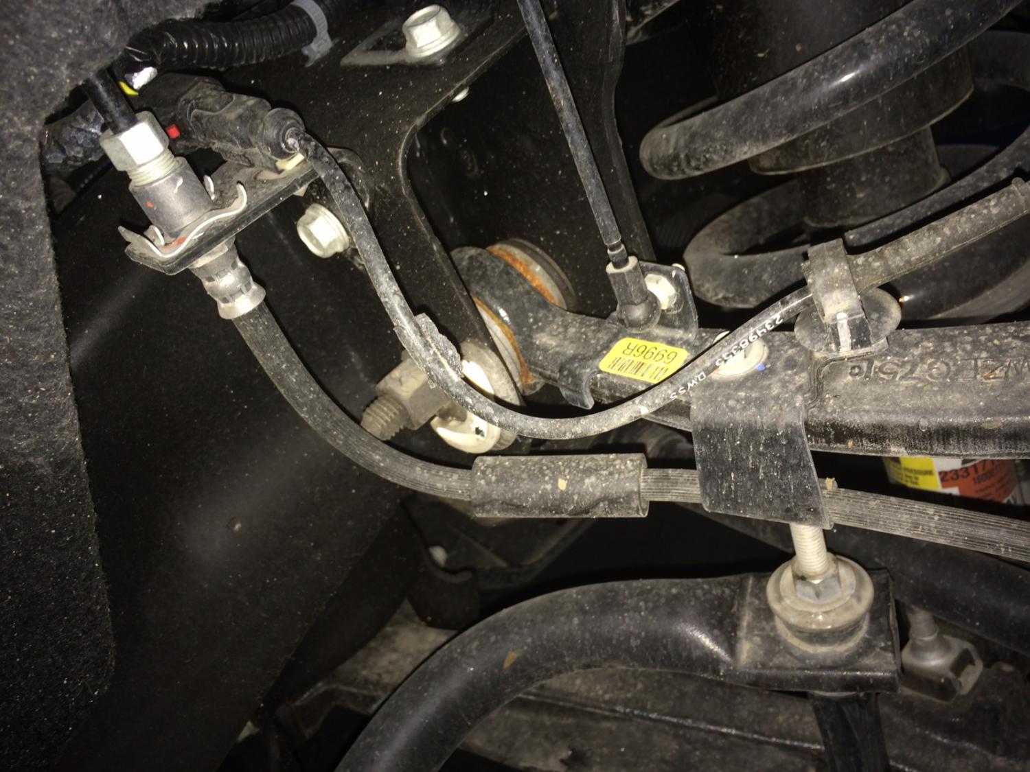

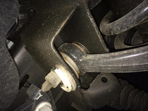

Looks like GM has dropped their forged Aluminum upper control arm manufacturer in feb 2016 and their forged steel manufacturer in March 2016 All trucks and SUVs built after March 2016 apparently have a stamped and welded lighter weight and cheaper upper control arm installed? They have about 4800 recalled for bad welds. It sure makes you wonder how strong the new design is going to be. Anyone with a post April 2016 or later build truck care to take some closeup pics and post? Mine has a January 2016 build date and has the forged steel control arms. Here are some pics.
post-127028-0-05914800-1468546022_thumb.jpgpost-127028-0-81317200-1468546036_thumb.jpg
couple more pics looks like size is limited per post post-127028-0-60470700-1468546203_thumb.jpgpost-127028-0-33612700-1468546220_thumb.jpg
couple more pics looks like size is limited per post attachicon.gifcontrol arm 1.JPGattachicon.gifcontrol arm 2.JPG
