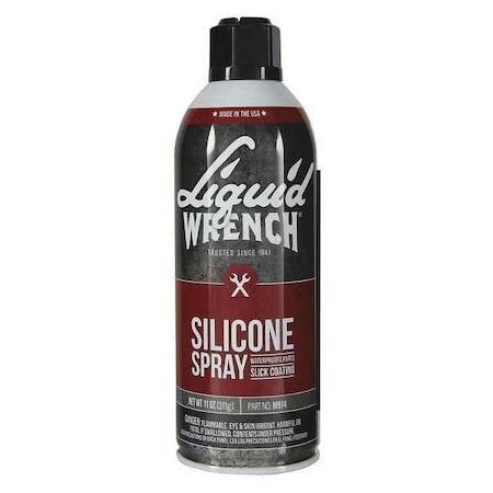

I found that exact liquid wrench stuff at auto zone. Says "rust prevention" on it so ill spray the stuff in tomorrow. Right now here in PA I don't need to worry about corrosion too much but in the winter it can get nasty. Some winters barely throw anything at us but some are pretty darn salty
