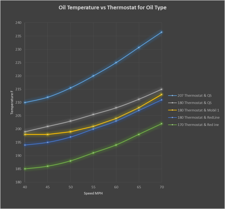

An Oils Base matters with regard to bulk oil temperatures.
Had this chart up a long time ago but time to revisit it. I started thinking about this again after listening to Lake Speed Jr. talking about rings and ring width and its effects on power and oil/water temperature. (Total Seal Corp). Ring friction is 40% of the engines friction and the single highest component percentage. They have a video on this that is very much worth the watching.
This chart shows three components. Water temperature as controlled by the thermostat, RPM as controlled by road speed and the oils friction as controlled by base oil type and additive packages. When I collected the data for this I had not as yet tested AMSOIL but have found it to be darn near identical to the Red Line HP for running bulk oil temperatures. Some time after collecting this data and quite by accident I found the correlation between oil temperature and rpm to be more of a function of the rpm and not the load as road speed increased provide the only additional load is speed. Okay with that in mind:
1.) For any given thermostat oil temperature will remain some constant above the water temperature for any given load and rpm. For instance, at 55 mph oil temperature will be about 20 F warmer than water temperature no matter what thermostat you use but it may be 40 F warmer that water at 70 mph for all thermostats. UNTIL the capacity of the cooling system is matched and exceeded.
2.) You want to see some high oil temperatures try running 55 mph in third gear for 20 minutes. 😉   I can't imagine pulling max loads up a 10% grade for miles at near peak rpm.
3.) WHAT oil you use matters. Isolate the three oils tested with the 180 F water thermostat. That would be the three center lines. Quaker State UD, Mobil 1 and Red Line. All 5W20 oils.
4.) Not on this chart is the data I collected using 5W30 which in THIS motor ran a few degrees warmer. No it doesn't always work out like that. My contact at Red Line explained that if a lighter oil reduces heat then it is still thick enough to prevent direct contact and temperatures fall due to lower fluid friction. If the temperatures rise with the lower vis the film has ruptured.
5.) As Red Line and AMSOIL produce the same temperature profile we can eliminate the boat load of moly in the Red Line as the source of reduction. Yes it matters but less than the base oil.
6.) Stacking can take as much heat out of the motor as an oil cooler. Moderate road speed + lower water stat + right base oil selection. 45 F in Peppers case.
