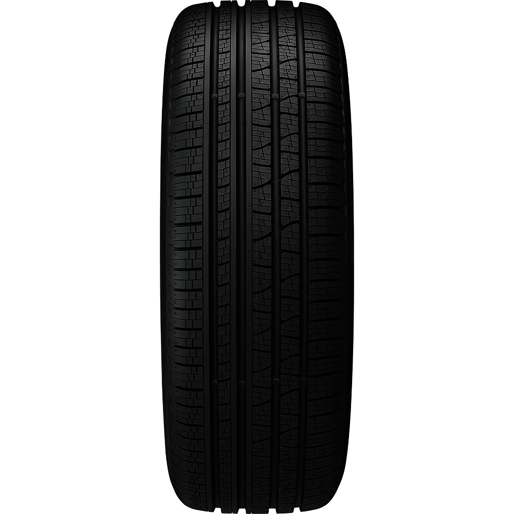

So....Pepper got her new shoes today.  Scorpion Verde All Season Plus II
PIRELLI SCORPION VERDE ALL SEASON PLUS II - 265/65R17
This tire is 1/2" shorter and....corrected my speedometer to dead nuts to GPS. It had been logging miles 1% low and speed 1 Kilometer per hour slow. I have removed that correction from the Scan Gauge II.
So the Bridgestone Duller HT 684 II that come off at 125,363 miles measured an average 5/32 plus. Even wear. This is a solid tire choice and literally price and the promise of a bit more comfort won. Now it it just delivers, eh?
First impressions with under 50 miles logged scuffing them in are:
1.) As quite at the Bridgestone was these are quieter. Just a hair and most of that over small tar snakes and road cracks. Dead quite on bigger stuff. No basketball bounce sound to be hear. That's what my ear said. What the sound meter said was 2/3 DBa louder. Well if it is it's in a place I can't hear it. (Phone mic and app) Could have been the wind. I do more sampling and compare with my notes.
2.) Ride compliance over same said tar snakes is better. Over all ride seems better but some roads are just plain bad. Stuff smaller than an inch in height this tires takes better. Past that the shocks/springs are in play and  you loose what is doing what. Is the the shock or the tire? :dunno:
3.) Roll out distance from 45 to 30 mph is the same. That surprised me as roller resistance diminishes with age and of the rubber (hardens) and less tread squirm with less tread. Well if that's the case it is a solid improvement as these will only get better too.
4.) Turn in is NOW compared to the old set. Effort is zero. Think the move and it makes it.
It is way to early to test lateral grip. Best part was the price. $151 a piece. Worst part was the newest set I could get a a few weeks over a year old. (In a matched set of the same lot).

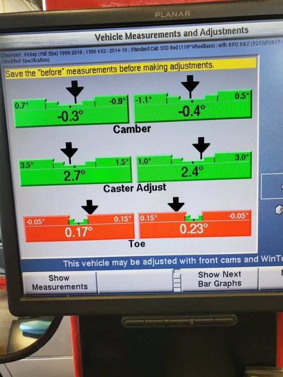

Ordered new extended range cams for both castor and camber. All four are frozen so setting toe was as good as it would get for today. Told 3 to 4 days for parts then next spot in the schedule.
11/10/2017 was the last alignment check and set at around 49/50 K miles. I should do this more often. I'm putting it in the schedule at 25 K intervals. Next at 150 K
Last 3 K miles the 6 period average mileage had dropped off about 1 mpg and I had an intermittent vibration that didn't seem to have a speed pattern. Pay it some attention I found it did it during certain sections of road and only it did it. Puzzler until I saw the toe which was way out and not shown thrust angle which was 0.2 degrees.

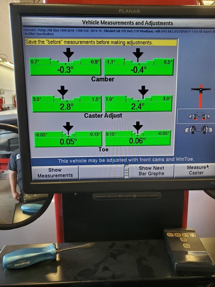

After the adjustment.
Not enough cross camber and to much cross castor and the castor target is about a half degree high.
Thrust angle is now dead ZERO.
Toe is huge in keeping AFM active. Goal here is to lower total camber yet remain negative and lower castor while maintaining a quarter degree cross on both parameters. Almost a drag racing set up to minimize rolling resistance. Just the toe made a marked difference.  I'll trim that a bit as well. In my area where I test, roll out distance netted nearly an extra 100 feet. You don't notice the deterioration over such long periods, thus the more frequent checks and adjustments. Fuel alone will pay for the extra work.
