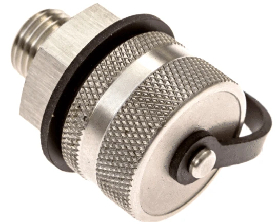

ValvoMax Oil Drain System
6/6/2021
Ordered this today. Hope it gets here before the next oil change. I looked at the others, Stahlbus, Fumoto , EZ, Famco and several others. This one was middle pack in price and top shelf in construction and attention to detail to the details. Like the cap retainer. (I'll try it but I'm thinking safety wire)  Loved the drain assembly which is a large star wheel that allows throttling for samples with a bare hand on a hot motor.  Compact and user friendly. 304 Stainless construction. Wave washer one way check ball. Full throated. Nice knurling. 😉
Yea, yea; as far as modifications go this one won't turn heads but it will turn a few less wrenches.
9 hours ago, pokismoki said:
what size is our drain bolt?
12mm x 1.75mm
Edited by Grumpy Bear

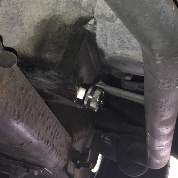

1 ValvoMax drain plug installed.

In the photo above the pan looks damp doesn't it? I sprayed it down with brake cleaner. 200 miles later...dry. I'm going to guess John wiped down with an oily rag. He knows how I hate drips. Still, I'll be watching this for a few thousand. If it wets again I'll add a black light dye indicator and go fishing.
