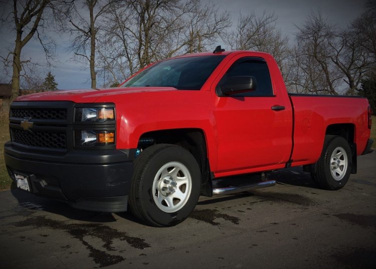

Haven't posted a 'fresh' photo in awhile. So I gave her a bath and snapped this in the parking lot. Yea, that's a scuff in the front bumper. :(  Yes this is her worst side. 😉
Local car wash has been bough out and the new owner has done some major repairs and upgrades. Did a nice job me thinks. In a few months she's 7 years old.  Think I'll keep her :)
