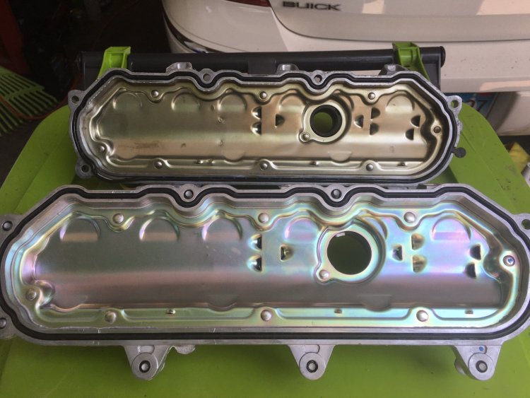

New drivers side valve cover/PCV valve and as it turned out that bank of coils. The replacement came 'loaded' with the hardware, gasket and superseded coil packs. For $55.79. Pretty cool considering the coils are $20.79 each purchased separately. I now have a few spare coils, a new gasket and an extra PCV valve. What it did not come with was the intermediate fitting for the oil filer cap and the lock broke on the old one removing it. Another trip to the parts counter. This one works fine, just comes out when you don't want it to.
Amazingly clean

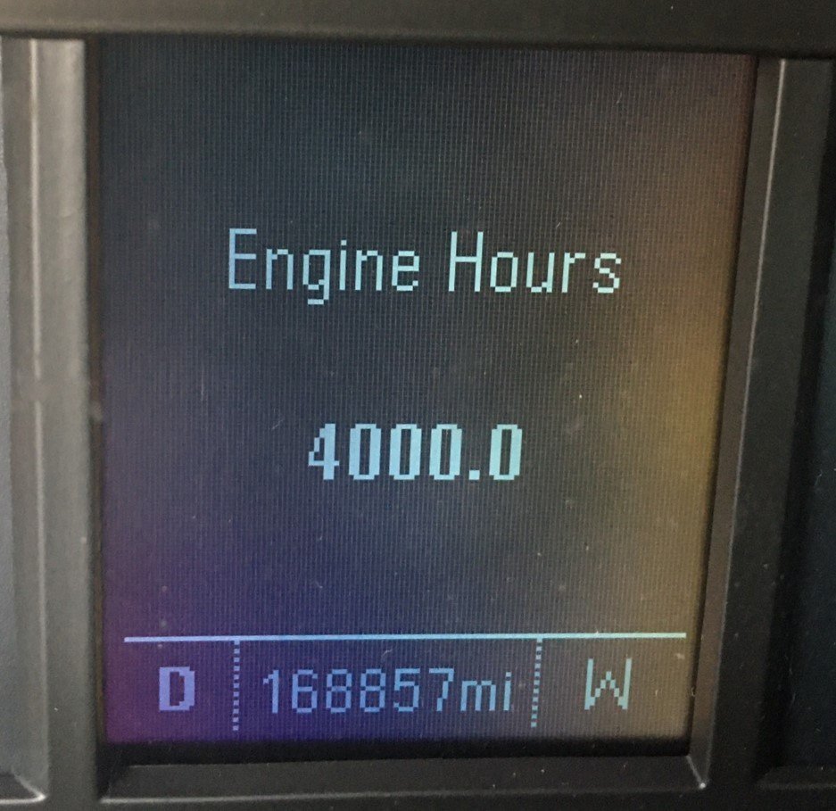

4,000 Operating  Hours!
42.2 MPH
7/21/2023
Or 500 eight-hour days in that seat. We are just getting acquainted.
