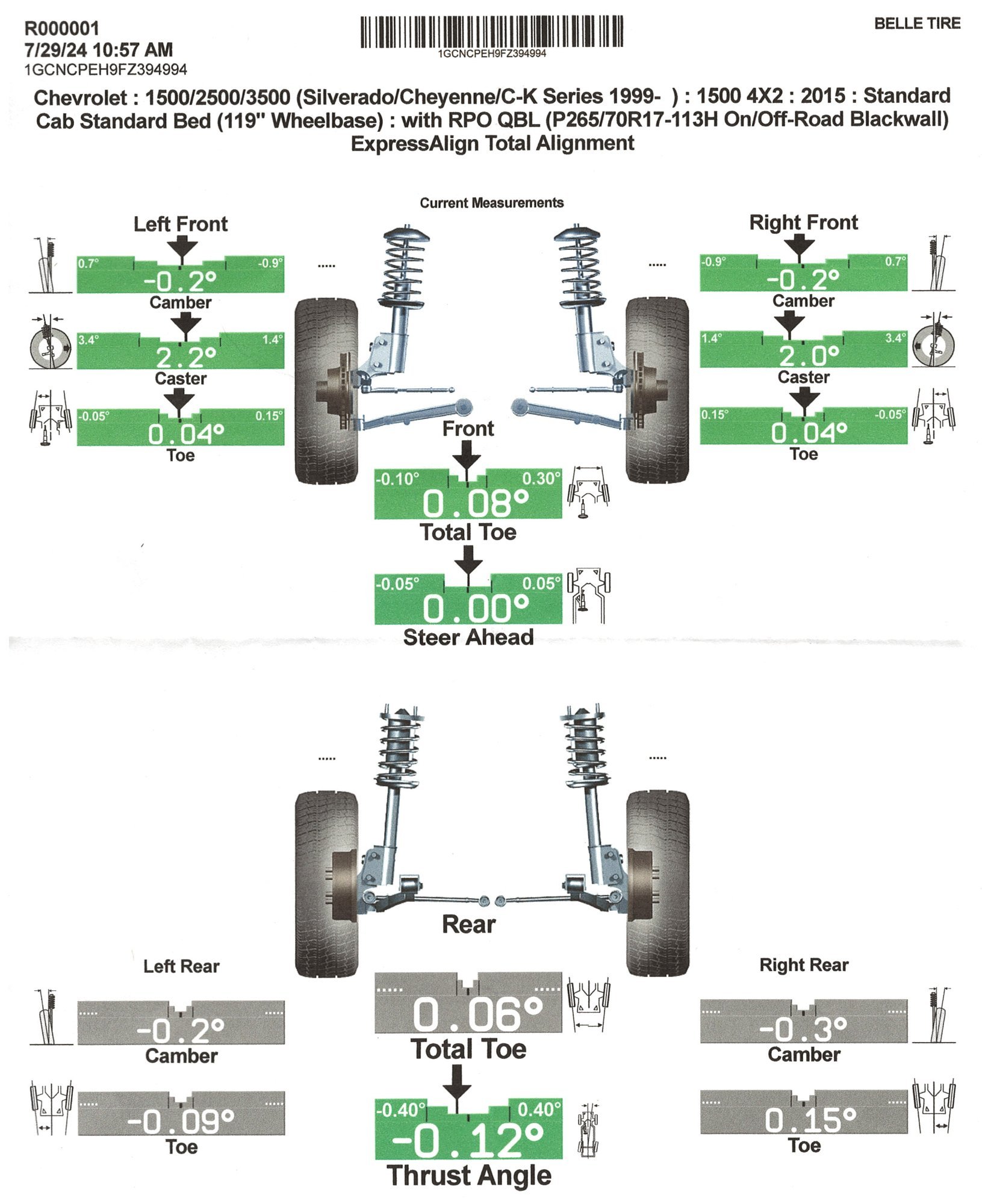

182,360 Mile Service
7/29/2024
Alignment.
Last alignment done 10/23/2020 at 130,300 miles or almost 4 years and 52,060 miles ago.
Last settings: Castor 2.2/2.0 Camber -0.1/-0.2 Toe 0.04/0.04 SA 0.00 TA -0.11.
Pre-alignment checks of tie rods, ball joints, A-arm bushings. All snug as new.
Initial Castor     2.2/2.0 Camber 0.0/-0.5 Toe 0.19/-0.04 SA 0.12 TA -0.11
Range Castor 1.4/3.4 Camber 0.7/-0.9 Toe 0.15/-0.05 SA 0.05/-0.05 TA 0.4/-0.4
Targets Castor 2.4 Camber -0.1 Toe 0.05 SA 0 TA 0
I prefer a to be light on caster and tenth more negative on camber. A tenth less positive toe. These specs were good for 125K out of the first set of Bridgestone.
