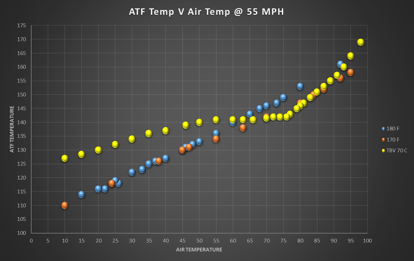

Hot weather again and more refining of the cooling charts. Between 50F and 75F it shows its throttling range of 142F. From 76F up it rides 66 degrees over ambient temperature. Inside that range it will run hotter given circumstances. Running faster or slower than 50-55 mph. Tailwind vs headwind. Terrain. Interstate, US Highway, county or urban all impact it but from about 90 F and below it will recover. Naturally the closer you are to the limit the longer it takes to recover. It will do this even hot soaked.

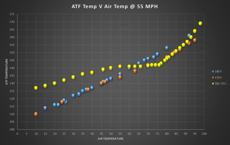

From last posting I included the pill flip curves at two different water temperature thermostats.
(New Graphs below)

Near 100 F today so finished up data collection. Last three data points show a radiator at 40% Glycol running out of capacity. Easy to see in the Delta T graph. Far right yellow both graphs.

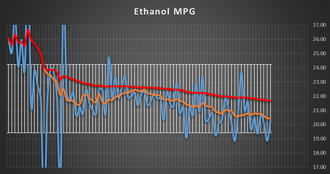

Think I've decided to stay full E-85 this winter instead of blending to E-45/50. I will hand me some awful tank milage be a bit harder to start and I'm good with that considering how this fuel treats oil. Even Esters.
Penny's make dollars. Lower tire pressures. Heavier oil. Cooler temperatures. Shorter trip lengths. Faster Interstate speeds. (I've added 5 mph routinely) As the graph shows; it's all adding up. :(

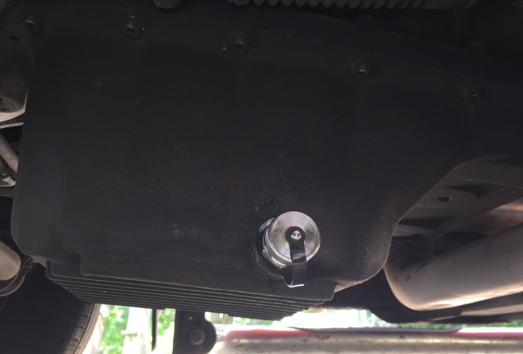

7-3/4 quarts of Red Line D6 transmission fluid. Half the charge, roughly.
1 Valvomax drain for the PML alloy pan. Slick.
Now I can do precision withdraws and refills.

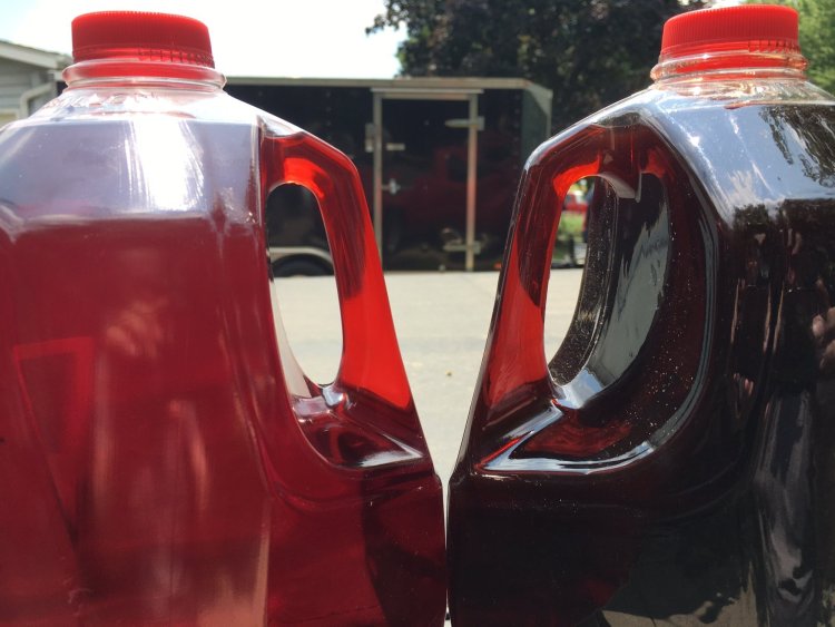

Guess which one is the new fluid 🤔
On the stick they are indistinguishable.
On a white towel it was hard to judge.
It was time.
