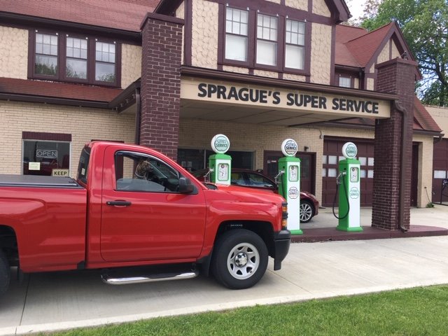

More US Route 66
(above)
Odell Illinois. Oldest station in this section of the route.
(below)
Sprague's Last of a breed of stations when the were ma and pa affairs
Google it. It has a rich history.
Re-post of Dwight to put them all in one place.
