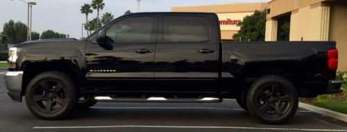

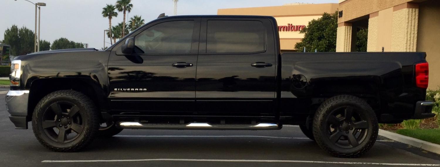

I got the 20" factory wheels with some
275/60r20 fallen wildpeaks at3 (33") with rc 2" level kit . Truck does not rub at all.
My question is I would like to pick up some fuel hostages 20x9 but would like that little aggressive look where the tire pokes out a little bit.
But not sure what offset I need. I tried calling shops and everybody was unable to give me numbers. Everybody keeps telling me to just get +1 offset - but they claim they will sit flush with the fender
Fuels available offsets are +1. +20. And -12. What do you recommend
Well your stock wheels are probably a +27 or so...I have a +12 on my menace 808's and they sit perfect IMHO...just sit flush with the nubs on the side of the tire sticking out...so a +1 should probably poke out a little and a -12 will be probably close to 3/4" or more out..I guess it just depends on how wide u think looks good.
