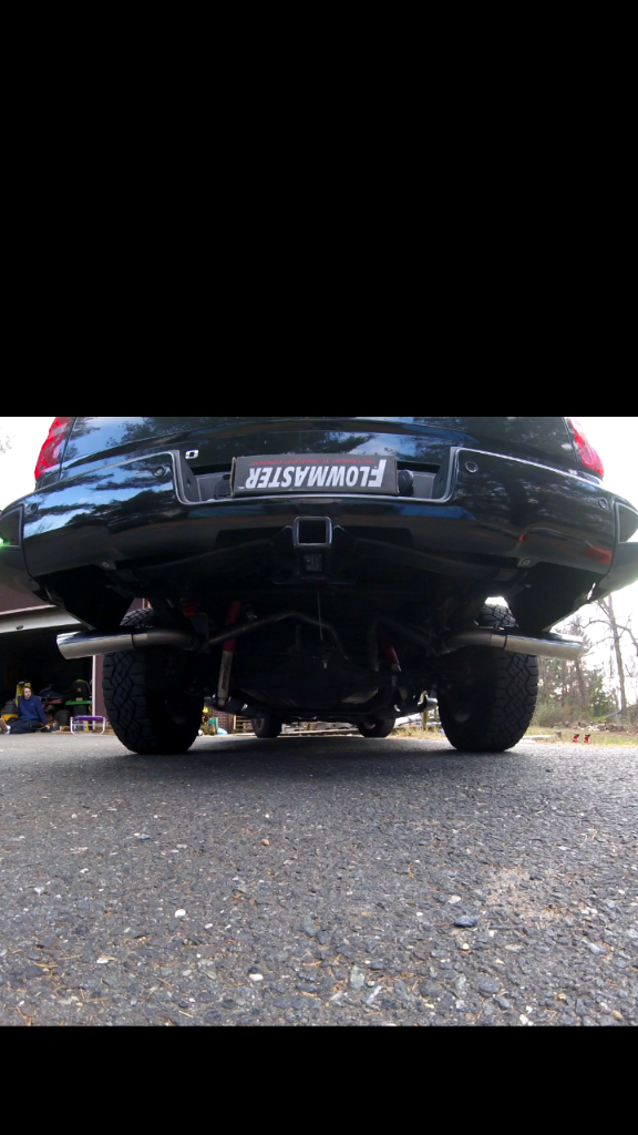

I got the force 2 cat back flowmaster for my 2015 1500 Silverado. Sounds awesome. Fit perfectly. The drone is pretty bad depending how you drive. post-152502-14848459763_thumb.png
