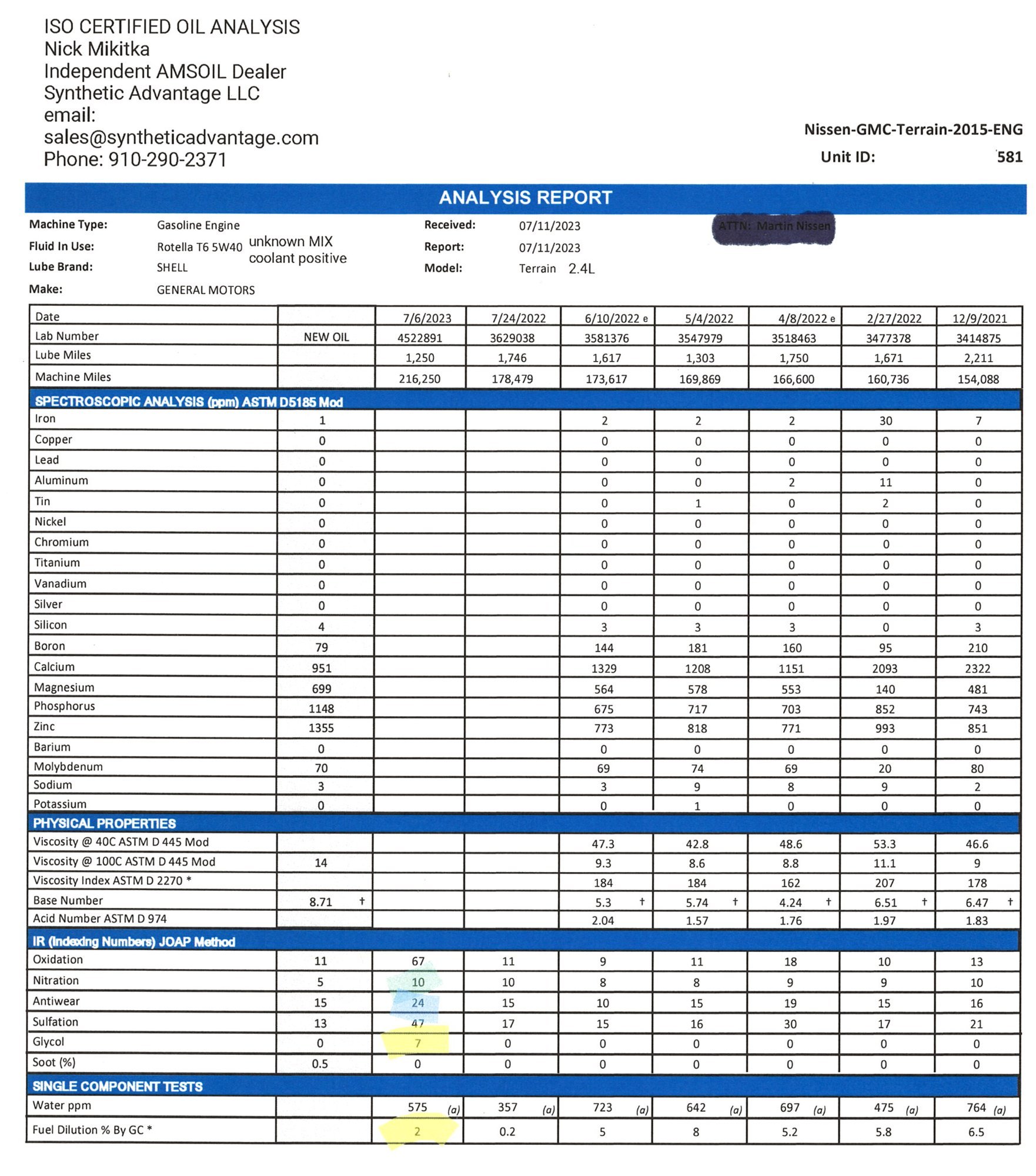

Know that saying, "Be careful what you wish for"? I wished to see the results of all this work. I got that and something I did not want to see. Glycol in the oil. Notes come attached with this report and among other things, "You have an issue OR there is some weird chemistry in the cleaner. I shot a note off to HPL supplying results to see what they may have to say.
They said, "Get a pressure check, it isn't the chemistry". These are some nice people at HPL. Sort of exchanges I use to have with Red Line before Phillips took over and sealed everyone's mouth shut. Anyway...
Oxidation is higher than I would have expected for the blend and glycol will advance oxidation rapidly. Put a question mark there.
Nitration was flagged. In spec but top of "spec". This one always gives me pause as I don't buy into the absolute unit methodology. Some oils start that high. I use 10 points over background. This is just a matter of 'school'. Blend average on typical base blend would be about 6 and small change. I'd get a raised eyebrow about 16 units.
Antiwear is typical for the diesel package of the oil and was noted as such.
A similar note was attached to KF water but not checked as while elevated it is still inside bounds. I find this as normal as can be on an orifice CCV system and a boatload of Esters which a KF mistakes as water. A head fake. Orifice systems are NOT POSITIVE evacuation systems. They are partial positive. Crankcase sees positive pressure much of the time in the inches of water ballpark. I hate these systems, but they are used often in motors tuned to give lowest possible pumping losses.
Fuel dilution. 2.0% Not ideal. Not uncommon for GDI either and it's pig rich start fuel mapping.
I like to troubleshoot in the Horses, Zebras, Unicorn method. Most obvious first. Pressure check it is and hope it's the cleaner removing hidden previous contaminants. Not likely but one can hope. HPL brought this up as a possible IF it passes the pressure check. Water pump would be next most likely and the one I gravitate towards. If this is true then we will do more than the water pump. While it can be replaced without disturbing the timing cover it ain't fun and as we have 200K plus on the timing chain and tensioners and a weep at the cover seal I'll have it all done.
If it is a Zebra or a Unicorn, we, Mrs. Bear and I, will reevaluate. I tip toward a remanufactured Jasper long block and she toward a newer something other. Until then this vehicle is on limited distance duty. 50 miles max and until repaired or replaced I'll stay with the shorter oil changes. Jason is working stupid hours and I'm having trouble getting shop time these days. So it stays in rotation, just on 'desk duty'.
Edited by Grumpy Bear
