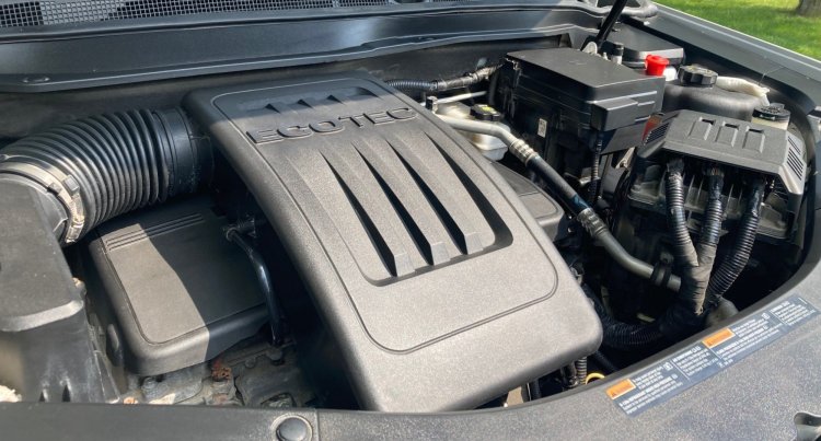

Under hood detail. Not allot of work. Don't let it get out of hand 😉
