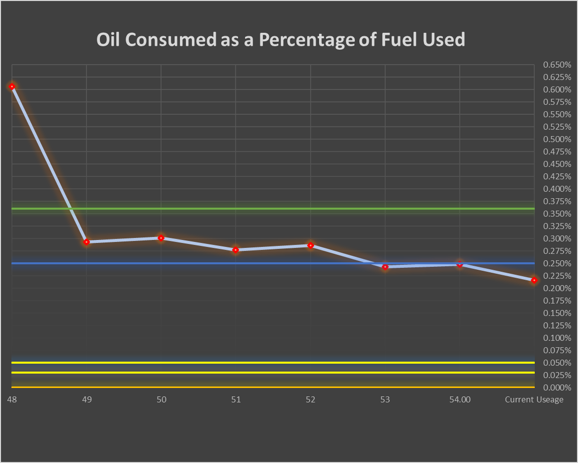

I haven't published one of these in a good long time. This chart is just part of a much longer history. That last high consumption point at the far left is the last use of 5W30 in this motor. The remainder are Euro type 5W40's and the last point, still incomplete as the OCI is still in progress, 10W40 HM. It is a long way from right but it has moved from a quart in a thousand or more to between 2500 and 3000 per quart with a slight improvement each OCI. Point #53 is the last tune up.
Current OCI is 750 miles into it and there is no color to the oil which is a MAJOR change in events. As reported earlier it has been measurably improving with each event.
It isn't going to heal itself but this is much more manageable. Back to daily driver but still fairly local. 50 mile limit or so.

Not terrible consumption for anything given the mileage. My Accord at 300k was using a lot more but I never went beyond 10w30 to try to reduce it either. It was time to take it behind the woodshed for other reasons anyway.

This one is getting there. Rust starting in ugly places and the transmission is hinting she's tired. :crackup:
Funny that recently it has dipped below the GM threshold for relief if it were still under warranty. They got themselves plenty of warranty shade. It's a ridiculous number the public is good with though. She's been a first class school room.
Want to hear something funny? P420 codes are not yet obnoxious! Full SAPS oils for this long and the CATS are just hinting 95% efficiency and O2's are still working? There's a lesson in the lie of SAPS. :rolleyes: A claim made the evidence does not support made without a means to test its validity. Just a guess. A theoretical guess.
