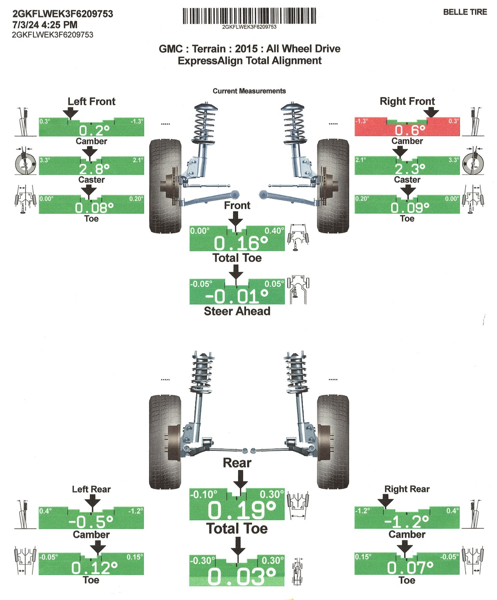

"Well, that's unacceptable!" popped right out my mouth. It was also 5 minutes to close and I'm down $2,200 and STILL DON'T have it right. :mad:
His answer was, ready for this? "Why"?
"Oh, I don't know.... because it's all over the map and out of spec?" I bark. Yea, I bark when fleeced.
He wants to challenge me on it but another tech who was present on the early visits stepped in when I reminded him that I PAID FOR AN ONE SPEC alignment and detailed what that meant to me and they agreed to my conditions. "That's true" he smiles, "twice in my presents". OMG :wtf:
I have an appointment at 1 PM tomorrow to FIX THIS.
Upon inspection this evening on my ramps I see the camber adjustment, a thing the last two shops swore was not adjustable and is, have likely never had a wrench placed on them. They installed the toe adjustment cams and called it a day. It fell where it fell and charge anyway.
Note; Belle Tire marks up parts OVER 100%. Hourly rate is slightly below local market but the figure hours funny. Breaking each component out separately as if each stood alone so you get extra billing hours for jobs whose book hours would overlap. just FYI. My eyes were wide open.
Update later after the next go around.

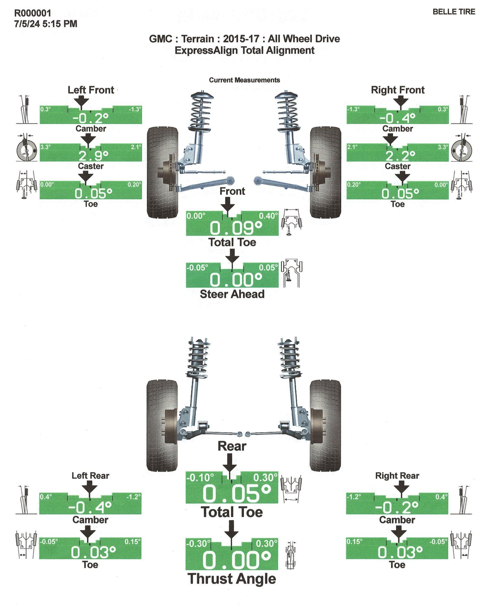

Got er Did!
What I asked for was -.20 camber all the way around and +.05 toe each wheel. Up front this is not too bad, and we just ran out of room on the 1.5-degree camber adjuster on the right side. Out back it was a different story. The camber eccentrics had not been touched since the day this rig was built although it had several four-wheel alignments over the past three sets of tires. Always, "Oh the printer was out of ink.", or "I left it on the seat of my truck" or "The dog ate my homework". :mad: What really happens is these are such pigs to get squared up no one even wants to try. Thing is I got tired of eating tires like popcorn at $1400 a set.
Left rear camber was as good as it was going to get after 5 hours (pitting in the eccentric) and close enough to make a marked improvement in most everything. Having added toe link eccentrics complicated the adjustment process. Touch one and they all move. Front and back. Another GM better idea. The toe link is straight as can be and could have more easy had a double threaded adjuster like the tie rod adjustment up front but no.....we will supply no adjustment at all.
Funny thing, after few years these parts show up in the GM data base. :rollin:
So, in a week or two we are going to put on a set of the cheapest asymmetrical all season tires we can find with block edge tread pattern and test this set up before I drop $250 a tire again.
All in all Belle has been willing to work to meet my requirements and the people not just responsive but pleasant. Plus as their shop rate I already clawed back almost all of the fat in the billing. :crackup:Sycamore, Illinois store is okay by me. Hat's off Jason and the crew. Extra shout out to Dan the alignment man.
Did you note the ZERO thrust angle and steer ahead? 😉
