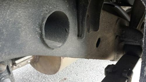

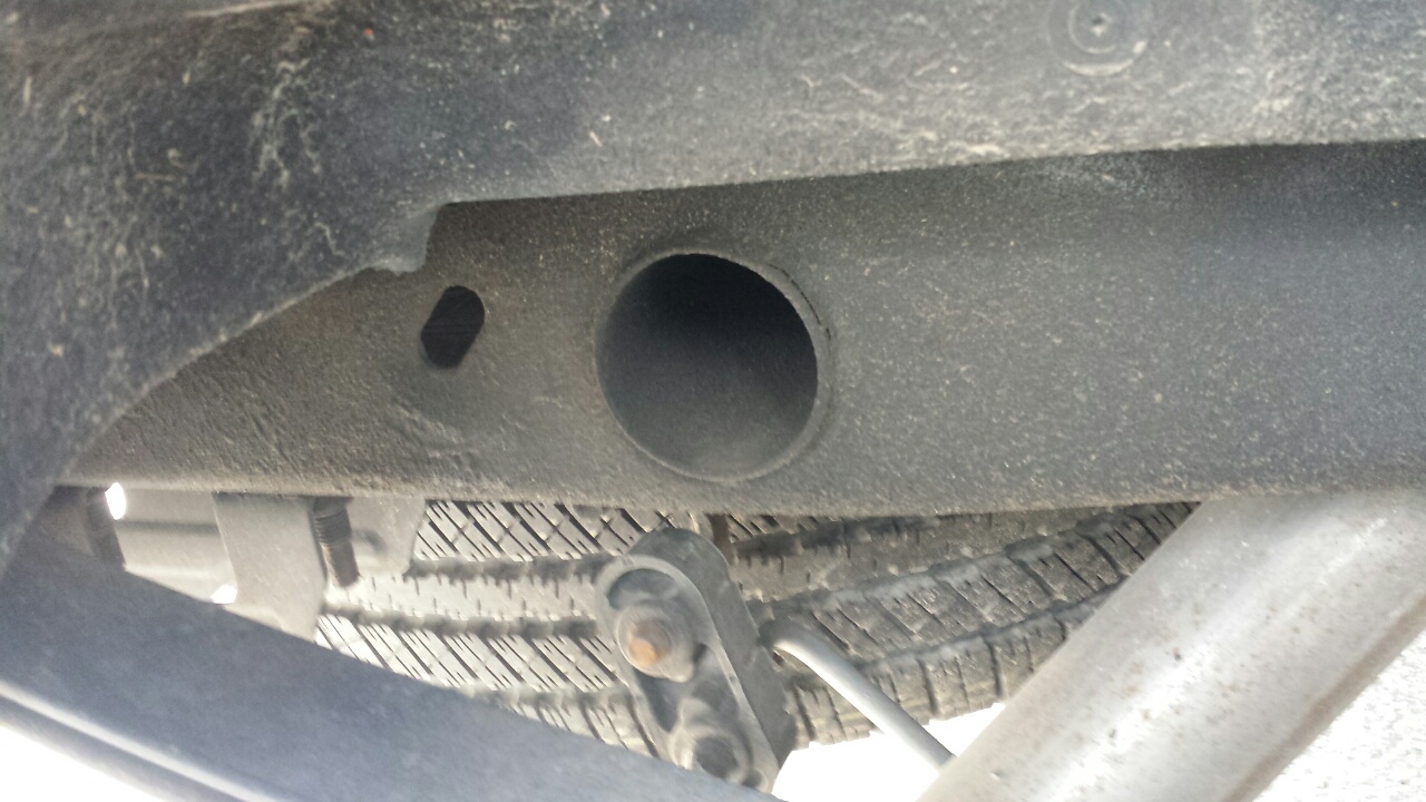

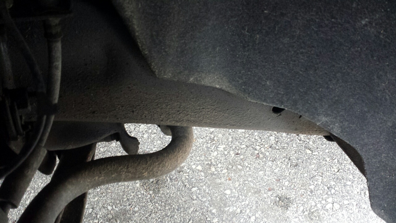

Here are some pictures after 1 year (2 applications).
attachicon.gif20150504_171056.jpgattachicon.gif20150504_171114.jpgattachicon.gif20150504_171157.jpg
That's what my frame looks like after about 2 coats of fluid film over a 7 month period. It literally takes me about 15 minutes to crawl around the truck and apply the fluid film. I'm very pleased with the product and how it interacts with the oem wax. Works great!
yep keeps the wax soft and tacky. I upgraded my front suspension after I took the pics and in the area where my breaker bar scraped against the factory wax, it scraped but didn't peel or flake away. I just hit the area with FF later on. And even today, no rust. I don't get what others are doing wrong or we're doing right to have these vastly different results. I love not having to wash my truck every day during the winter!

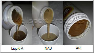

My wax hasn't "shriveled" or peeled off like you are so adamant will happen. I've applied FF over a dozen times now. Maybe your pro's were using the thinner version because it's easier to spray. Mine is the stuff on the right.
