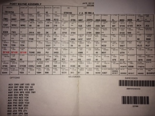

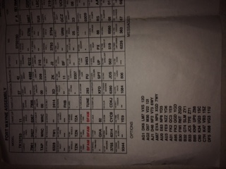

I'm wanting to change the front and rear gear oil in my 2000 GMS Sierra 4x4. I hear some people say to use an anti-friction additive and others say not to. I believe that if you have the G80 rear differential you do not use it. How exactly do I determine if I have the G80 or not???
I didn't see G80. Is there another initial that would indicate it's a limited slip differential?
No, G80 is the option, no G80 then no locker. Trucks do not use Limited Slip, those go in cars.
Note - 1999-01 models is was rare to find a G80 in them. Back in fall of 2000 I was looking to buy a 2001 Sierra E Cab with a G80. There was not one to be found on the locator within 500 miles.
