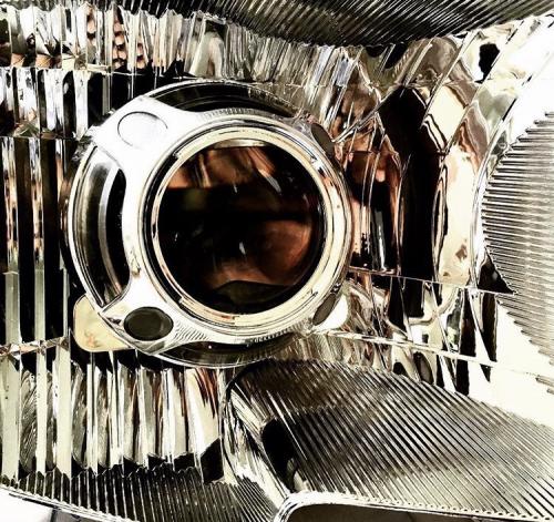

I had some heavy duty HID's on my last truck. 55w Morimoto XB D2S bulbs in the FX-R projector (one of the best on the market).

You may be able to upgrade to a 55w ballast if your stock is 35w for example. And if you want to get crazy you could disassemble the housing and retrofit a better projector inside. That's a lot of work though (what I did to my old f150 headlights)

To get "amazing" output out of a HID projector you have to get top of the line and retrofit. That's what I did with my F150 like I said earlier. Bake open the housings, extensive modifications, aiming is a nightmare lol, but the results are awesome !!
The stock headlights were just halogen reflector buckets. Here is what I did.
TRS FX-R projectors.
