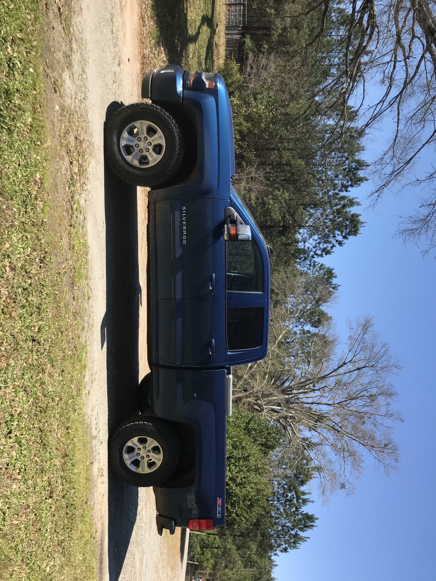

35 on truck with stock rims

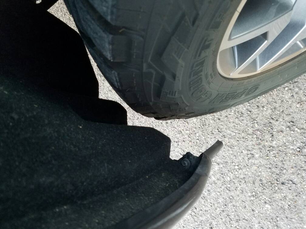

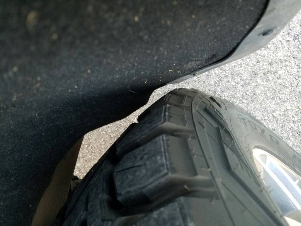

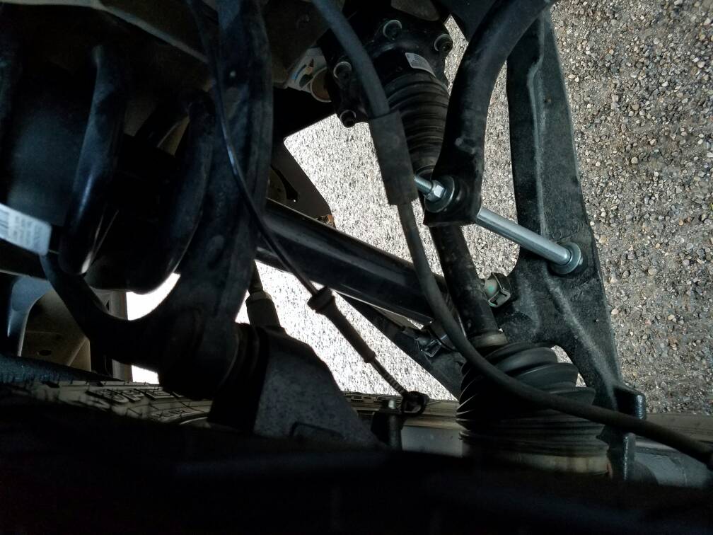

Here are some pics of the drivers side at full lock in both directions.
post-143469-149031616906_thumb.jpgpost-143469-149031617585_thumb.jpgpost-143469-14903161799_thumb.jpg

Thanks for the pics. No rub on the sway bar or anything either. Looks like any rub would be when the suspension is compressed in a turn but looks like its not that bad.
