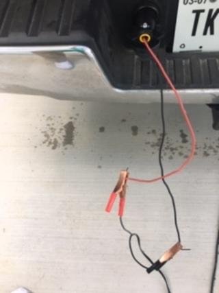

truck.jpg.86edd0e265c15c089179d39a5ebd6a58.jpgI bought a trailer connector and put in a Red 10 ga. wire to the 12 volt terminal. I put a 10 ga Black wire to the Ground. I have approximately 12" of wire coming out of the connector and stripped off an inch or so at the end and curled it, making it easy to connect the Red and Black leads to the wires from my Harbor Freight battery charger. I use this setup everyday. I park in my driveway, not in the garage due to getting a weak signal. Be sure to turn the automatic headlight switch to off. I pull the plug when I leave and hook it up when I am home. No need to unhook this charger at night, it has an automatic shut off. No more popping the hood and slamming it shut to hook up a charger. I also added a wifi extender to cover my whole house.
