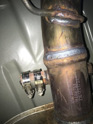

Here's the fix for the stock valve.
Twist it clock-wise and clamp it.
Still some good info in this old thread.
