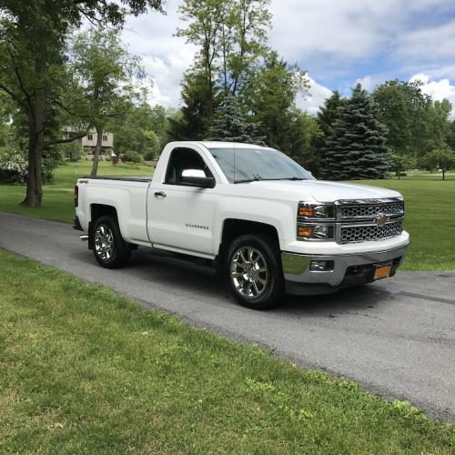

I just put brand new Denali wheels and tire pulls on my 2014 Silverado. I can get the TPMS into learn but my ATEQ VT5 will not sync the tire. I start at the left front tire at the valve but after I push the tool button nothing happens. Am I doing something wrong?
