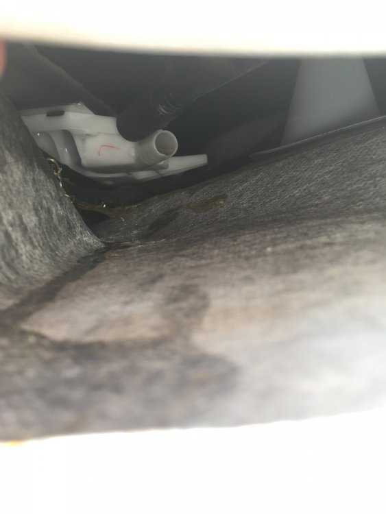

I have a 2015 gmc SLT Denali .... I noticed water damage on the headliner from the windshield to the Start of the back window all on the drivers side.... water tested Everything ! Sunroof , shark fin, windshield , roof rails.... all perfect... I started removing the headliner from the drivers seat didn’t find the source ... moved to the captains seat behind the drivers side removed the plastic panel where the seat belt comes out then pulled the headliner down...... BAM!! Pool of water!!! The rubbing tube that connects to the AC to drain out was completely disconnected! I thought it was an exterior leak because it had been raining.... but once I noticed water damage the whole way down that side and some old and dry and some wet I decided to remove the headliner enough to peak in.... !!

Hi sorry yes it’s an SUv I also have 3 trucks ford and GM. My Denali has the roof AC vents in the second row. I’ve been hunting reason to explain the random roof leak... I’ve seen shark fin , roof rails , and sunroof after all those checked out just fine I still tore it apart only to find it was a tube from the AC disconnected cause the leak! E water drained all the way up to the windshield. Maybe this could be an issue with trucks with AC systems running behind the headliner. :)

Don't think there should be any AC lines in the roof of any trucks. No ceiling/roof vents or cooling system for the rear like the SUV's.
Looked like an SUV, our Tahoe has the same setup, works great to cool our 4 huskies down.
