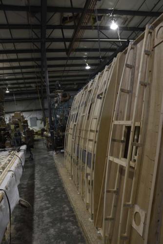

Jayco. Join the Jayco owners forum and poke around. Tons of TT info on there. I own a 2016 41' jay flight 38FDDS.. wooden frame with aluminum siding. It's stationary on a perm site.. check the forum.

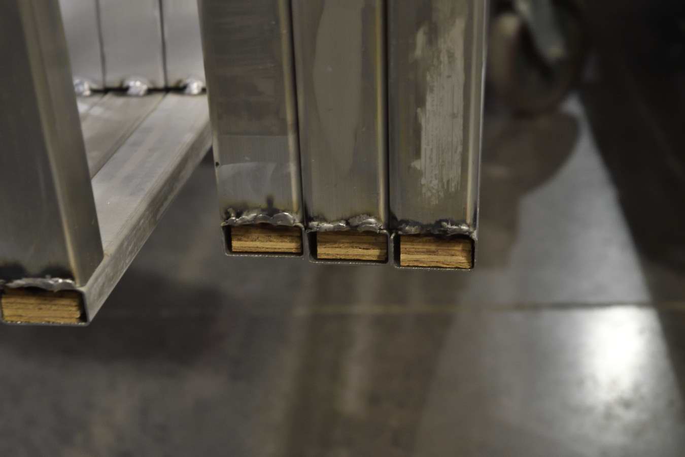

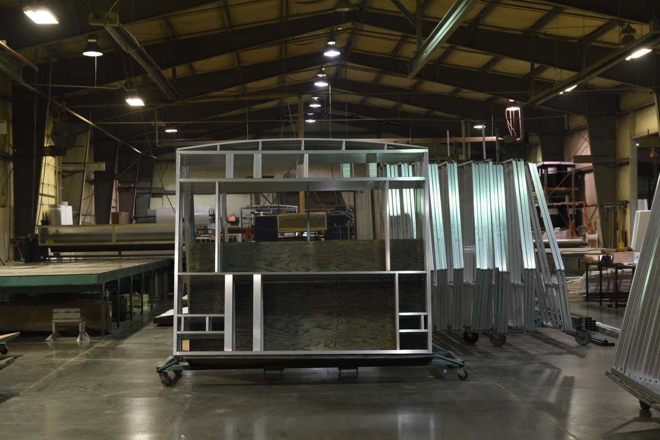

I don't know what you want in a trailer, but we decided we didn't want a slideout. And, we wanted something on the smaller side. So, we ended up buying an Arctic Fox 22G. Walls are aluminum framed, welded construction. There are wood inserts placed inside the aluminum tubing wherever fasteners have to go into the framing. That way there is plenty of "meat" for the fasteners to grab onto. Attached are a couple of pictures from our recent Northwood mfg tour (mfr of our trailer). The roofs are wood trusses. However, they are not held together with just staples. They use similar looking ties that are used in home roof truss construction. Northwood does make an all wood framed line, Nash.
If you are shopping by price, then aluminum framed could be out of your budget. But, don't let just the framing determine why you buy one. Northwood also builds their own chassis. And the chassis are independently certified to what is close to home earthquake standards. Nash's chassis are the same way.

The wood will not rot unless you have water intrusion in which case it's usually the floor that gets most affected. They ALL have plywood flooring. Important to maintain the sealant on the rubber roof and around all the seams. Another consideration is fiberglass vs aluminum siding. Both have their ups and downs. Fiberglass is known to fade and delaminate, while aluminum can't dent quite easily. Fiberglass is expensive/difficult to repair, while aluminum is easier and less costly to repair.
