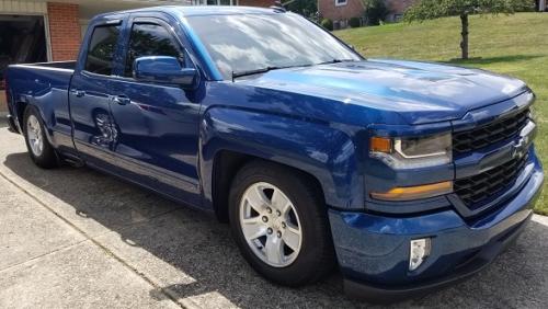

Do you have any pictures or videos of how it's set up under the truck?
Sent from my SM-G950U using Tapatalk
I'll grab some later today and try to get a better vid.
Here's the set up, cost me $219 it's all 3in stainless steel. I used 1 45 elbo $27.97, 1 4ft 16g pipe $35.95, and the magnaflow 14419 muffler $85.18 and a blk AFE resonator tip $69.00 all from summit racing

I love it, sounds good and I think it looks good to. I was going to buy a kit but didn't want to spend 1000+ on something I could make my self for 1/4 the price

True it's louder than a rear exit but it's really not to bad....when your just putting around, Now when you do WOT that's a different story
I did similar. Bought a Flowmaster Super 44 3 inch and a Flowmaster tip. Took it to a local shop and they charged me 100 bucks for custom bent 3 inch and install. Love the sound and the look. And I don't have to worry about axle clearance since I dropped it 9 in the back.
Do you still have V4 mode active? If so, how is it?
Yes I do and I removed the flapper valve. I get a little bit of a helicopter noise but it's usually only if I'm driving next to a wall or something that reflects the sound on the passenger side. 99% of the time I don't notice it. I think the trade off is worth it.
