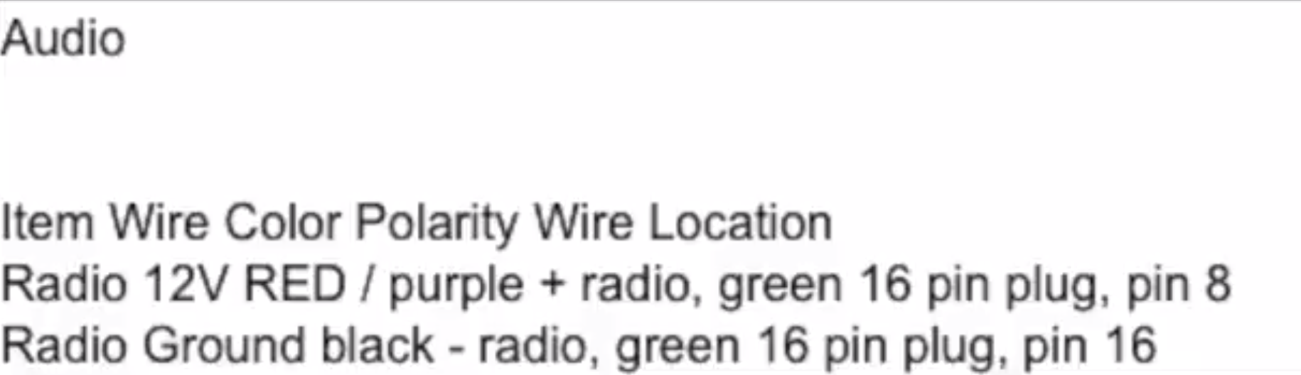

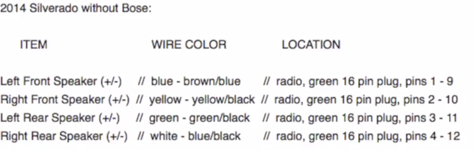

I ended up getting the console sub from Rodney's Boxes off ebay. Rodney substituted a Soundstream ST1.700D mono amp for the Kicker so I could mount the amp inside the console. Rodney's included an 8 gauge amp wiring kit. My truck is a 2014 Sierra SLE crewcab no Bose, no amp
Install highlights - wired amp to battery, went thru firewall at driver's side grommet with fish tape. Tapped into right rear speaker leads from Green plug at the headunit. The Soundstream had speaker level inputs which I combined the RR +/- from the headunit to both +/- amp high inputs. I also tapped the headunit ground to connect to the high speaker level ground input (in addition to the channel negatives). Grounded amp to a front dash chassis bracket mount.
Amp settings - subsonic filter around 30-40Hz, low pass filter around 80-100Hz.
Impressions - the sub really can shake the truck. I've got the remote turned down to maybe 3/10. Bass is impressive and tight. For $420 I'm tickled to death
this is the pinout for the green plug at the headunit. I tapped into right rear output for my hi level amp inputs. I tapped into the headunit black ground wire also for the ground of the hi level amp input
