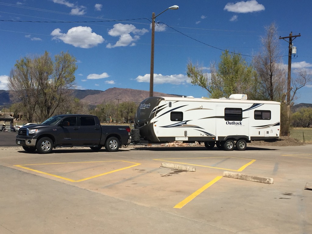

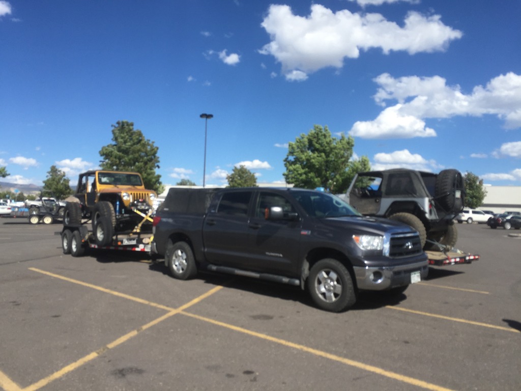

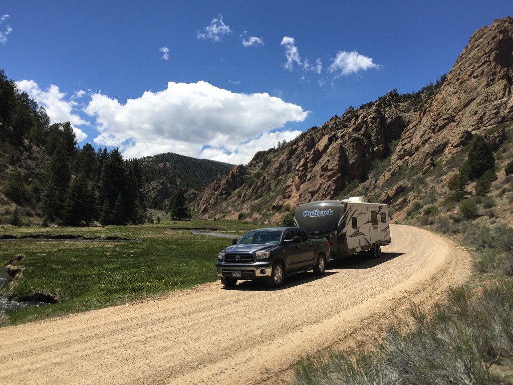

Your Cuz is overweight, period. I was really pushing the limits on my Tundra with a 28' Keystone. The killer was when towing my Jeep. 9K behind a 1/2 ton gasser just killed it. Now I only tow in the mountains for the most part (why would I go camp or Jeep on the open plains right?)
Now that I am back in a diesel and a 1 ton, I just can't ever see myself going back. I have been on both sides of the fence, and it is greener in this case, in every way.
