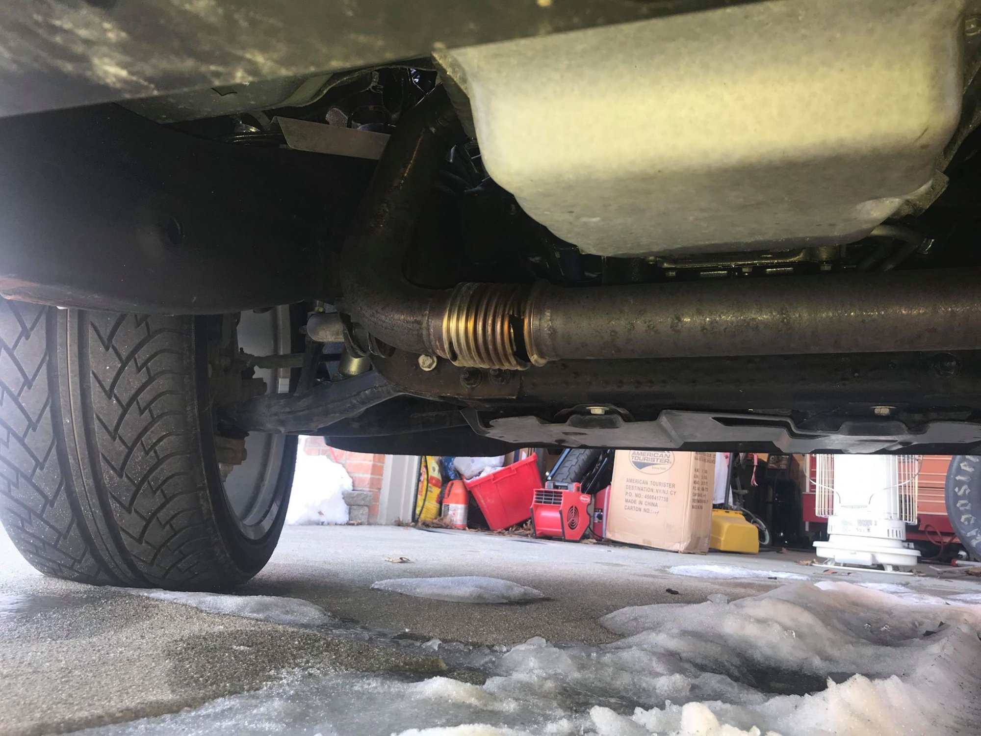

I has been a few weeks now. I have been working on my drag race car, tube chassis and body now. Weather clearing up so I started the truck and tested it. 4.5lb of boost max. Went threw all the vac lines and reran then. All looked good. Gate is working.... SO it has to be control issues, right.... Good so I finally install the last 2 exhaust augers and re clock the exhaust to clear track bars... When my helper said this is a problem as he is under the truck.
I have him take a photo. Yeah I would say that is why it can't build boost over 4.5lb, turbo only sees half the engine..Ugh I will email ON3 now for a new crossover. Looking at it I can see that blow out spot had the most flex and the Max heat.
**** new crossover will have stainless second bung for down stream o2****
see pic the flex is blow way out... Emailed Bob @ On3 to see what they can say or do....

Yes so Bob at On3 is shipping me a a new flew joint. I will also have my fab guy weld in the extra bung. Blowing out the flew is interesting the thought it the turbo is to aggressive or small. I'm on the fence with that as it pulls only 4.5 lb on half a engine. hard to think 4 more cylinders can change that much at 15psi. For the money I think I may just order the S475 and see what happens..
