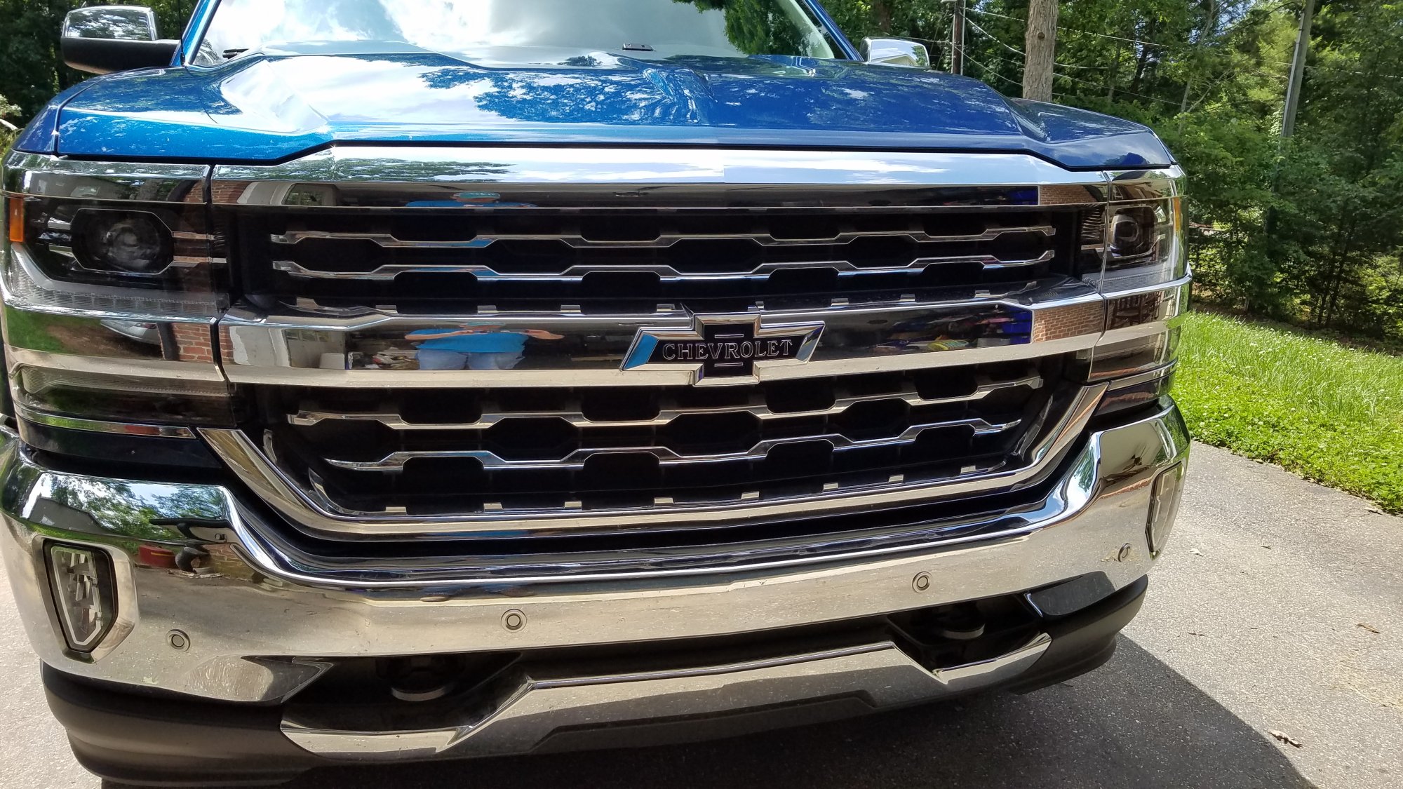

Centennial Edition bowties installed.

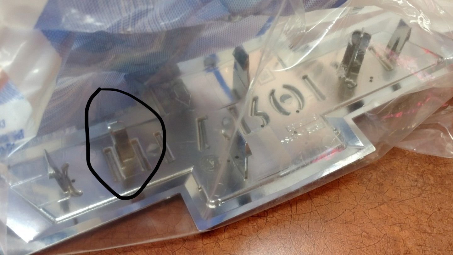

They sure will, I have them on my '16.
The front bowtie will need one of the small locator pins cut off, but everything else lines up perfect.

No problem !
I was surprised when I was installing mine because all the clip-in posts are identical, but the locator pin on the left side in this picture that looks like a T is in a different spot on the '16's....With a x-acto knife and wire cutters it was easy to cut it down a little shorter and it snaps in perfect now.

Awesome, thanks for the updated pic!

You're welcome, glad I could help.
I honestly forgot about that pin needing trimmed until you asked.
