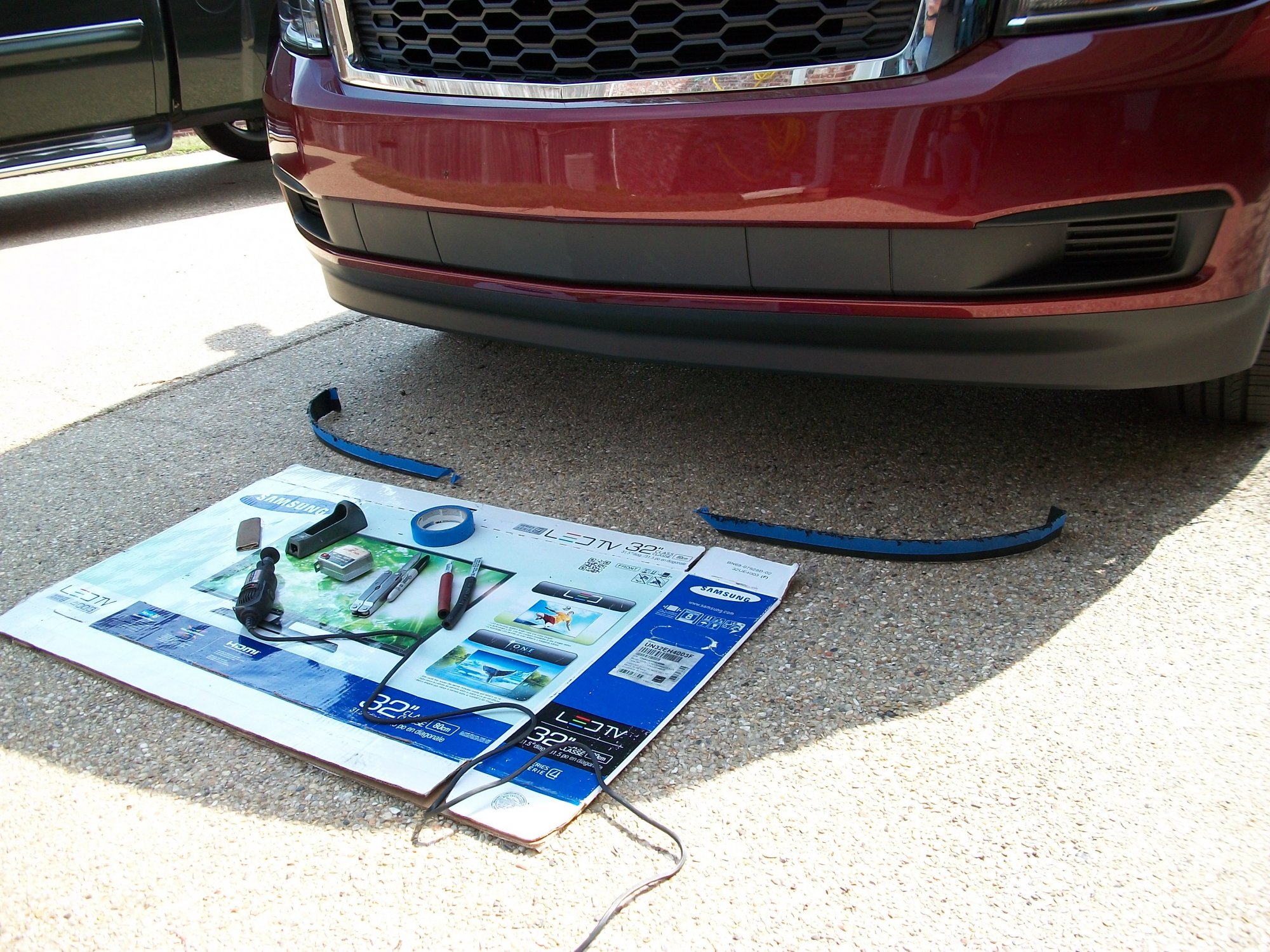

Finally trimmed my front valance

Alright, digging up an old post that I've posted on before.  What did you guys use to cut?  I just lifted the truck 6.5" and have 35s on Moto Metal 18x10 -24 offset.  Only time I hit the valence is in reverse close to full lock. It seems too thick to use a razor or anything like that.  Any tips?
Although the cut's not so drastic and it is on a Tahoe valance, a Dremmel tool, hacksaw blades in rubber hose, surform grater, knife, masking tape, and sandpaper will get 'er done.
Solid, man. So I’m good going with a dremel?
Worked for me.  Take your time.
I laid up two parallel strips of tape and cut between them as a guide.  Smoothed off the edges and was done.
Awesome! I appreciate it! I’ve got a pretty solid line where I’m going to cut that is on the mold.
