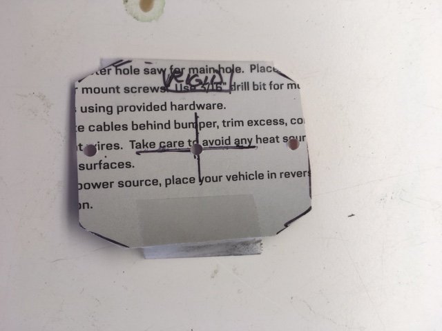

I recently installed the Rigid Back Up Lights in the bumper step. Very clean look. Light output is awesome from these very small lights. The install was fairly easy. I made a template using the light itself and taped it to the plastic to locate my holes for drilling. You need to position the light a little more on the outboard side of the step or the back of the light housing and / or wire will contact the truck body. Probably the hardest part was installing the top nut on the backside. After numerous tries, I was able to get it started holding it from the top with a long set of angled pliers placed through the opening between the bumper and body. Positive wires are connected to each factory backup light via a T-Tap, wrapped in electrical tape and the wire is protected in split loom. For the ground wire, I crimped on a ring and attached it to the bumper. There is a small screw conveniently located on each bottom corner.  I am very satisfied with these lights. You barely notice they are in there...
