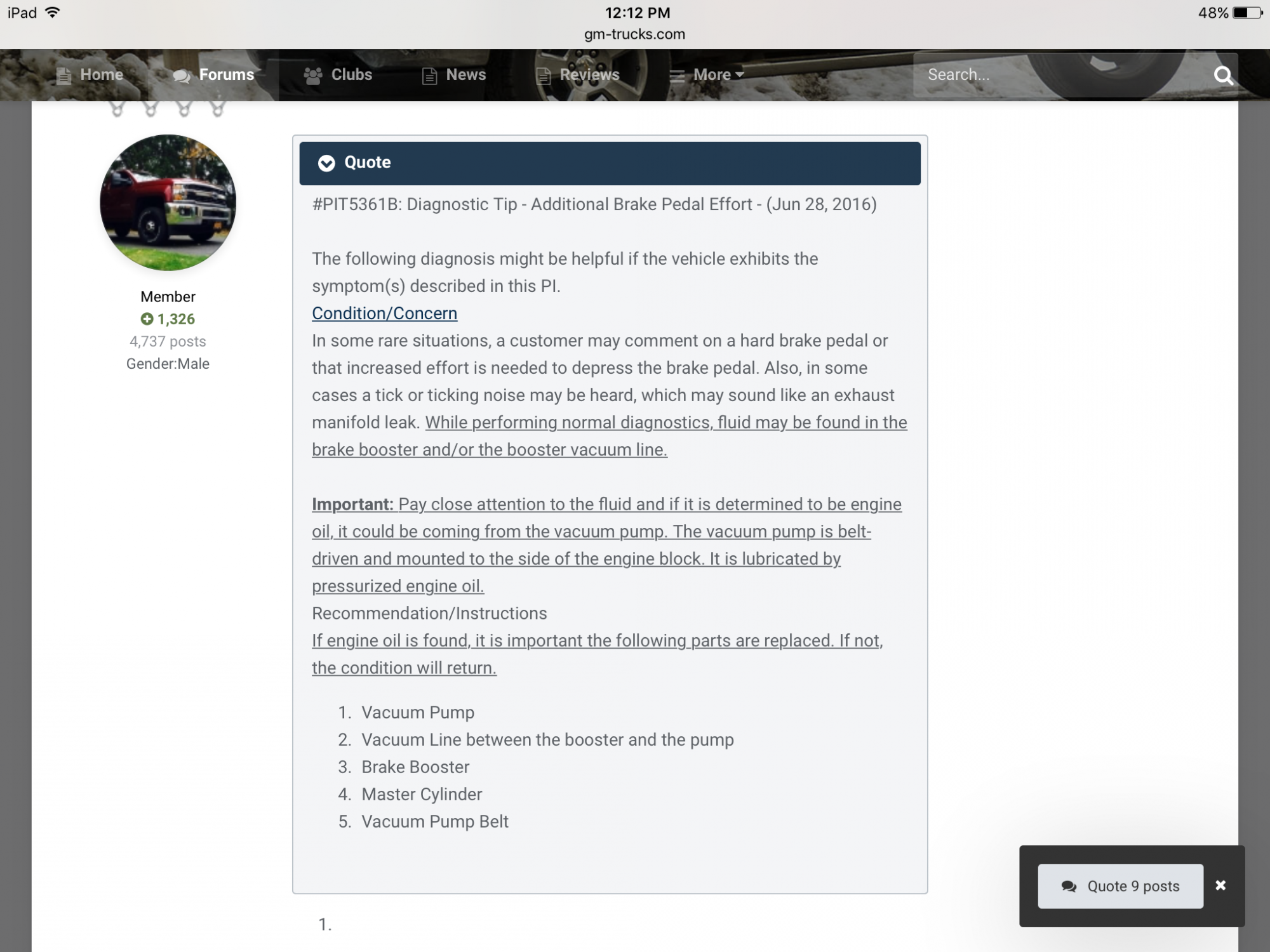

Lucky you survived:
Thanks for this. The dealership said that they have to replace all the items listed at the bottom of the page you posted. They said all the parts should be in tomorrow. Ill update this post when its done.

Dealership called and said the truck was finished! Ill advise how everything goes tomorrow after i pick it up.
I picked the truck up this morning and everything went smoothly. GM Certified warranty covered the parts (they replaced everything listed in the TSB). The truck idles quieter and the brake pedal feels better when i need to really get on the brakes. So far im a happy man :)
