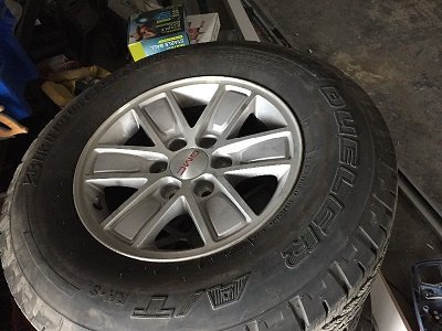

I currently have the stock 17" 6 spoke GMC wheels. They are good looking wheels but I do appreciate the enhanced appearance that 20" wheels can have on a truck.   I have come across a set of 5 spoke Silverado 20's which  are also appearing on new GMC's.  Without any consideration to tires, which are a better choice?  Is there any functional or aesthetic advantages to one over the other?  I have kept up with the threads on this topic but wondering if there are some current perspectives.  At this point the only justification I can come up with is that these 20's would be a refreshing change for my very average looking truck!

wheelsb.jpg.f14246b10bbd1867183d52818039d818.jpgwheelsa.jpg.a28e68d8f52025f6dc9361be91dc5229.jpg
20 inch tires cost more to replace than 17. 20 offer crisper handling. 20's you have are Chevy design. Does center cap transfer? Aesthetic is a personal preference though.
These are a Chevy wheel and centre caps should be able to be switched.  This wheel, in black, is standard on GMC blackout models.  I do think of 5 spoke as Silverado and 6 a s GMC but this is not always the case!  The idea of crisper handling is compelling.
20 inch wheels are heavier than 17's so probably a small hit in mpg, they will ride a rougher and be more expensive to purchase tires. They will handle a little better though and in some cases they look better, though a clean aluminum wheel with a slightly larger AT tire looks best IMO and is more functional in most cases.

I like the look of your 17's more than the 20's in those photos.

I also believe that the 17" looks better in these two examples.  The 20" isn't bad and if there was some other advantage to 20" rims, looks wouldn't be the deciding factor.  My wife couldn't see the difference in the wheels so there will have to be justification for a switch greater than looks if significant money is involved!   ;-)
