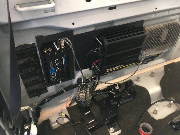

I used abs plastic and double sided tape to mount on my back wall. They are out of the way and secure but it sucks to remove the seat to make adjustments initially.

Also, order a shorter rca if using a lc2i.  I have a 3 ft one now but didn't at the time of install and now i've got to remove my seat again to get it swapped out (maybe one day lol).  That's the only real downfall of the amps on the back as previously mentioned.  Otherwise I like how they and all the wiring our secure and out of sight.  I just wish trimming the factor insulation piece neatly was possible. No matter what I did it always had snags and looked a bit junky.

Did you screw these right to the rear of the cab?
Everything is mounted to a piece of plywood that's been painted white. That was then attached to the rear wall with a combination of Velcro and liquid nail.
