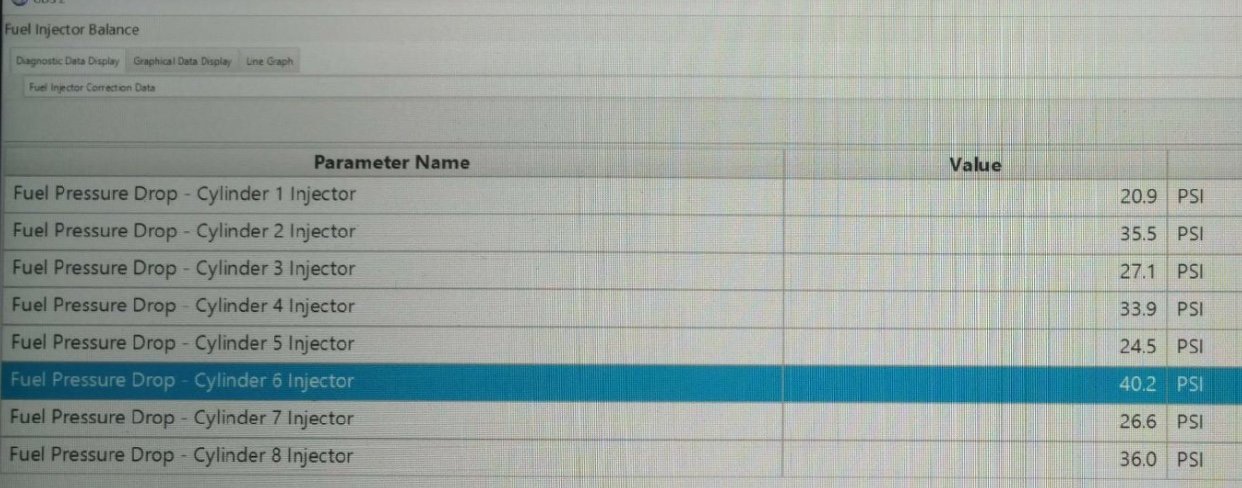

Update #2 for today:
The service manager contacted me and said he went for a ride with the tech and he asked him to check the fuel injectors as it reminded him of when one went bad in his truck.  They ran a balance test and didn’t like what they saw so they ordered all new injectors.  See attached balance table.
No codes/CEL, etc.
I will report back on this once I have the truck back or more info.  Hopefully this is a smoking gun and can help others.

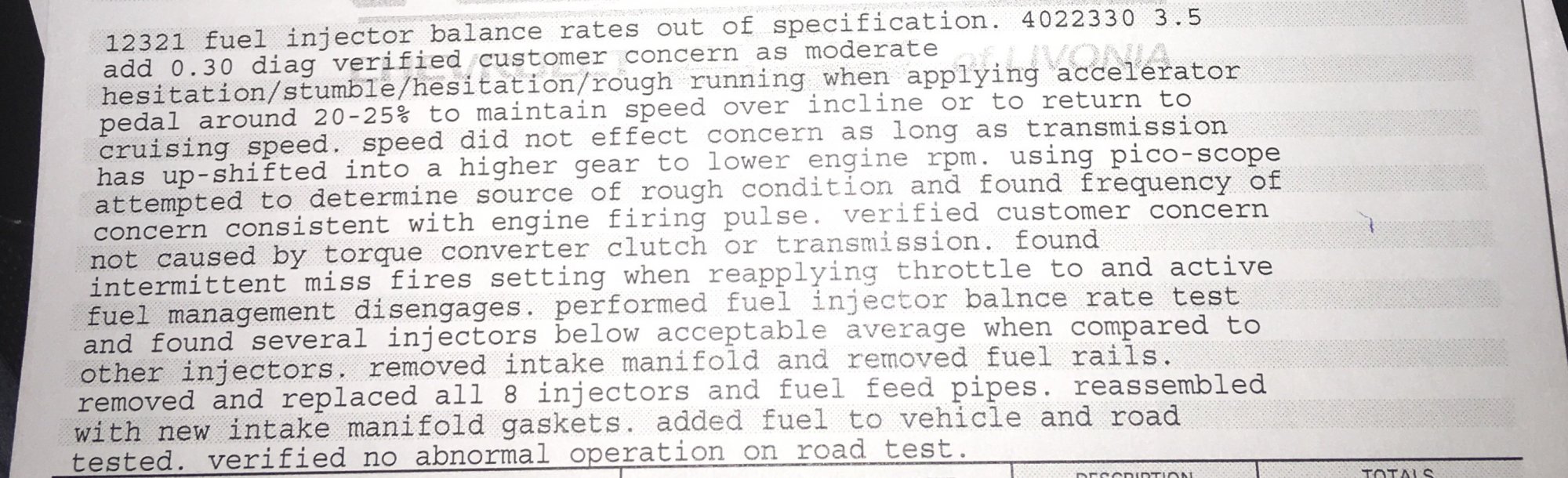

Update:
Got it back today and it seems to be a lot better, if not fixed. I still feel an occasional shudder, but I did in the last two loaners I had.  I will be making a 1000 mile trip next week, which will be the real test.  Here is the data from my work order:
3 hours ago, SGS_Z71 said:
Update:

Me too.  It was the smoothest drive I’ve had in a long time, I can say that.  I just have doubts that they fixed the root cause versus just a symptom of it.  I find it hard to believe I had that many bad injectors.  Also, don’t know if anyone noticed, but the low/high pressure drops are tied to each side of the engine 1-3-5-7 and 2-4-6-8.... curious right?
That is interesting.  I wonder what spec or allowable is?  Unfortunately in this time of “value improved” components it would not surprise me if there is a bad batch of injectors floating around and they have either not identified them or enough people have not made enough noise.
