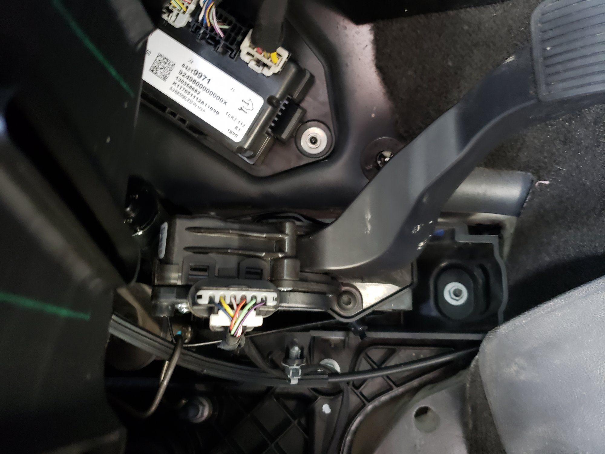

So I bought a 2017 gmc sierra elevation, after I got it home I noticed hesitation or like a surging when accelerating. I went to dealer a few times, had all computers updated, a new torque converter installed, I bought a tuner, got a custom tune, still the same piece of crap. Gm said nothing they could do as long as check engine light wasn't coming on that's the way I had to drive it. I started checking things on my own, it's almost a year now and I think I finally figured it out. It's the garbage fuel peddle, it's made of plastic and mounted on plastic, it moves up and down on plastic runners. If you reach in and give it a shake it feels like it will fall off. Well I moved the pedel all the way to the top and used some zip ties to anchor it solid, now the truck operates like it should, what a difference, no more hesitation. I'll definitely test it more and again bring it to gm to have it looked at.

Post some pictures if you can please?
