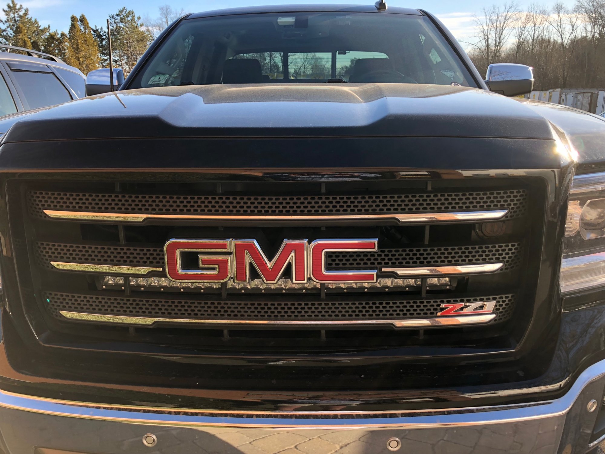

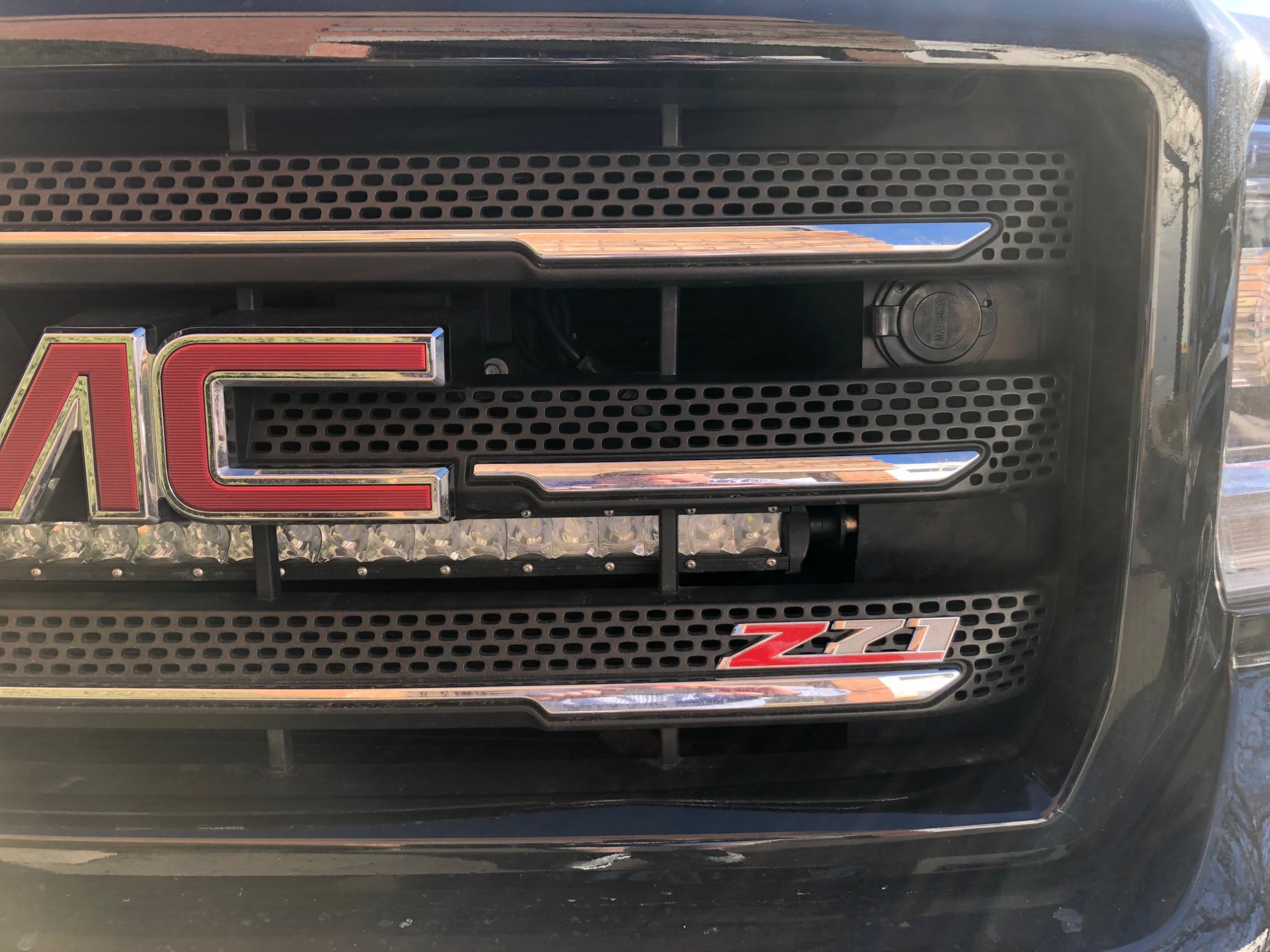

I had the OEM Block Heater installed last week with a Marinco Black 15 Amp 125 Volt On-Board Charger Inlet and mounted it here on my A/T Grill....
5a6b23d39963f_On-BoardChargerInletMounting3.thumb.jpg.0cf3e2d451065cdd25b4ad691b208ef9.jpg
5a6b23d576a89_On-BoardChargerInletMounting4.thumb.jpg.b5ee7e0fbaedd94e4b5c4e84f278f93f.jpg
Nice install. Very clean
