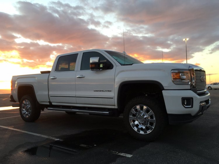

Going to level my 2018 2500HD. Looking to see what size tires everyone is running on this setup. Want the most tire I can. Don't mind trimming if I have to. Thanks in advance!
Because of the offset of the factory wheel you’re stuck with a narrow tire. I have 275/65-20 and have now issues with rubbing. I think 35” is about all I can get in the wheel well (front to back) but most 35’s are 12.5” wide and the UCA might rub the sidewalls

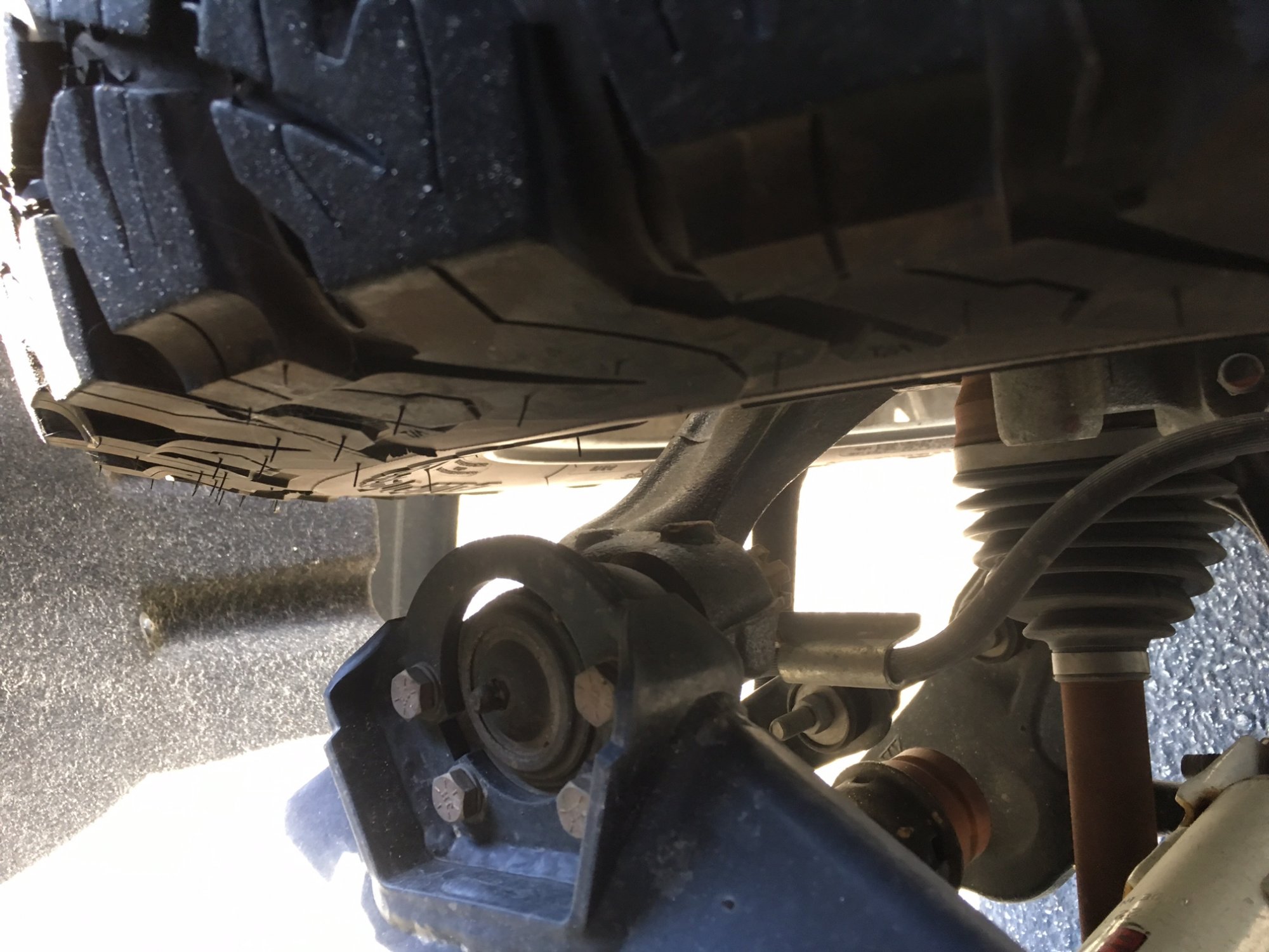

I will take a picture of my UCA when I walk outside. I think you’ll be ok, it’s only about .5” closer. I thought I had at least and inch. I’ll take a picture in an hour

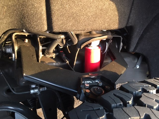

Here are some pics of a Central Coast Motorsports (CCM) upper control arm showing sidewall clearance. Tires are BFG KO2s in 275/65R20 on stock wheels...no issues with this size on a stock rim offset. Also, no other fender rubbing either. Trimming was not required...
I agree with Waaazooo...if you run too wide of a tire and /or a rim with a different offset, your UCAs may rub the sidewall...
