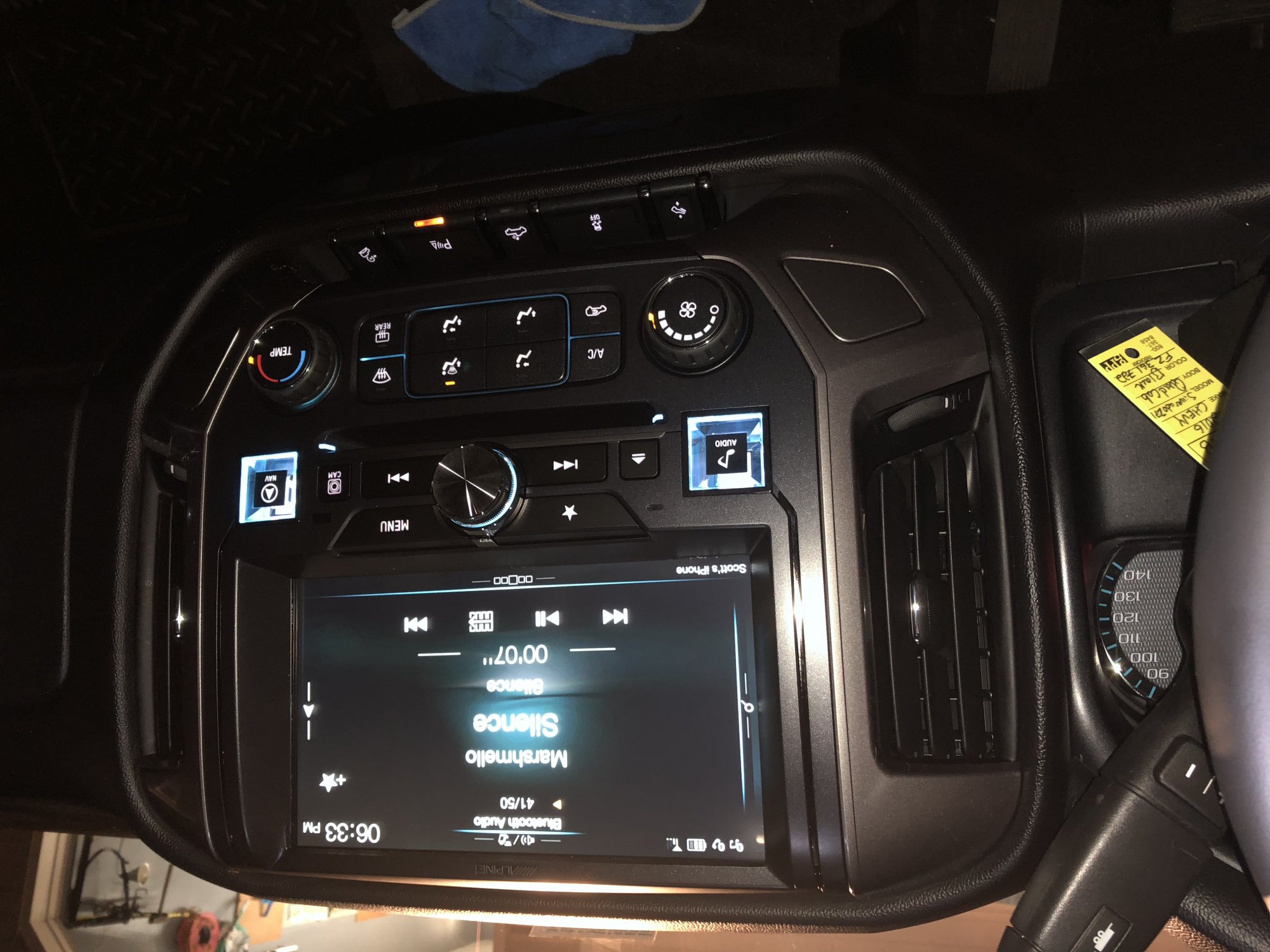

Hey guys anyone with a restyle kit do the brake bypass? I have some questions and would love to do it. Just not sure where (which harness) I need to do this at. Please let me know. Love my restyle kit just dislike that I can’t change settings on the go. 24162590-64EA-497E-82A1-85D587C54F3A.thumb.jpeg.abc407f2c1095612384af5d818994098.jpeg
*turns laptop upside down*
Looks nice. What is a brake bypass? I'm guessing to make the unit think the brake is engaged? Interested in your longer term review on the unit.
Yeah no idea why it posted it upside down? But the unit doesn’t allow you to change settings unless you have the parking brake engaged. Which is super annoying especially when first getting used to it.
