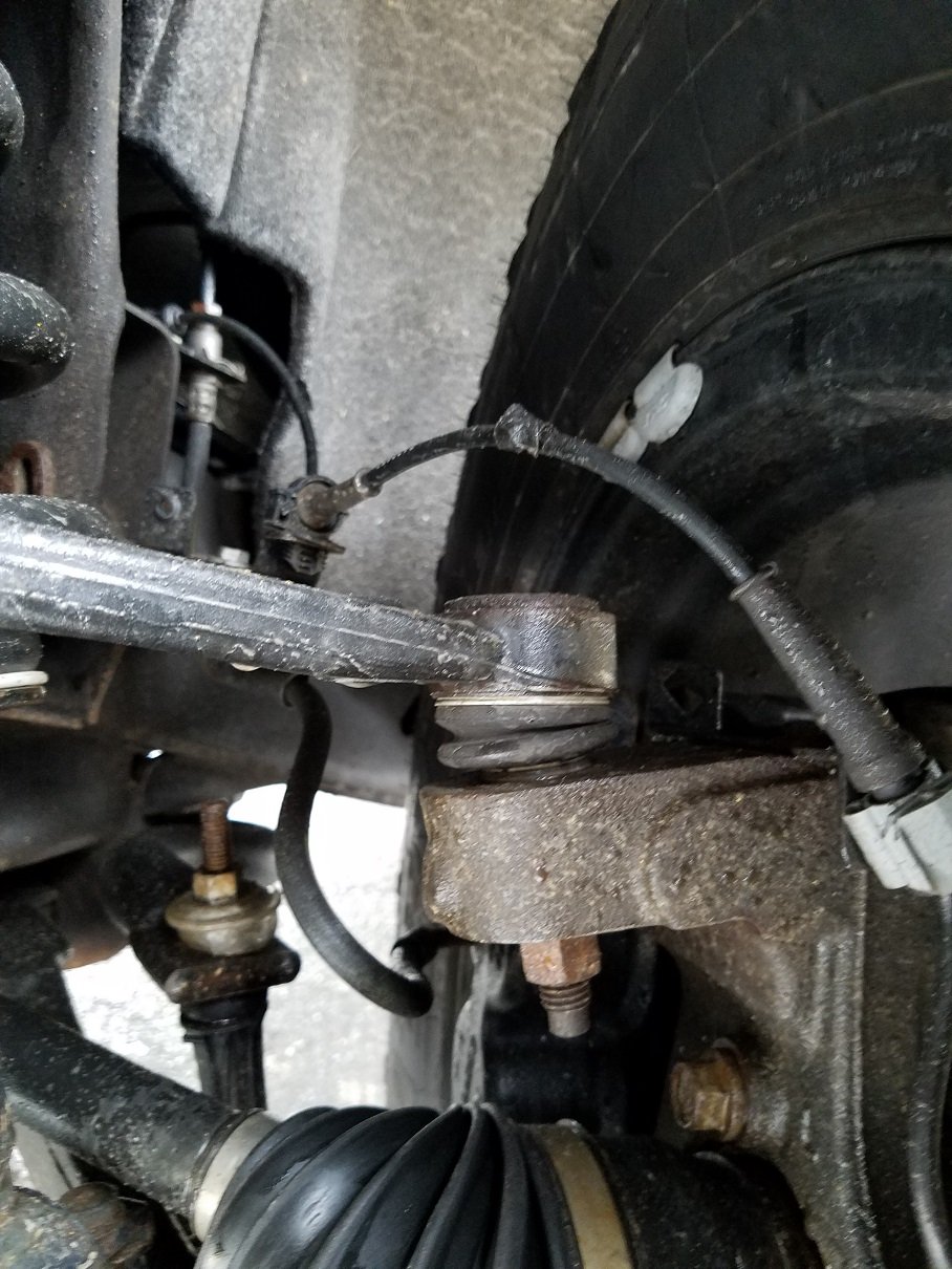

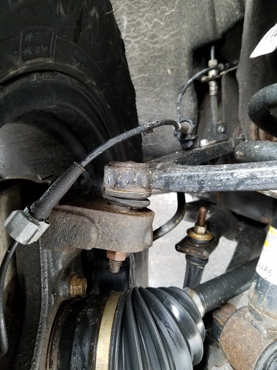

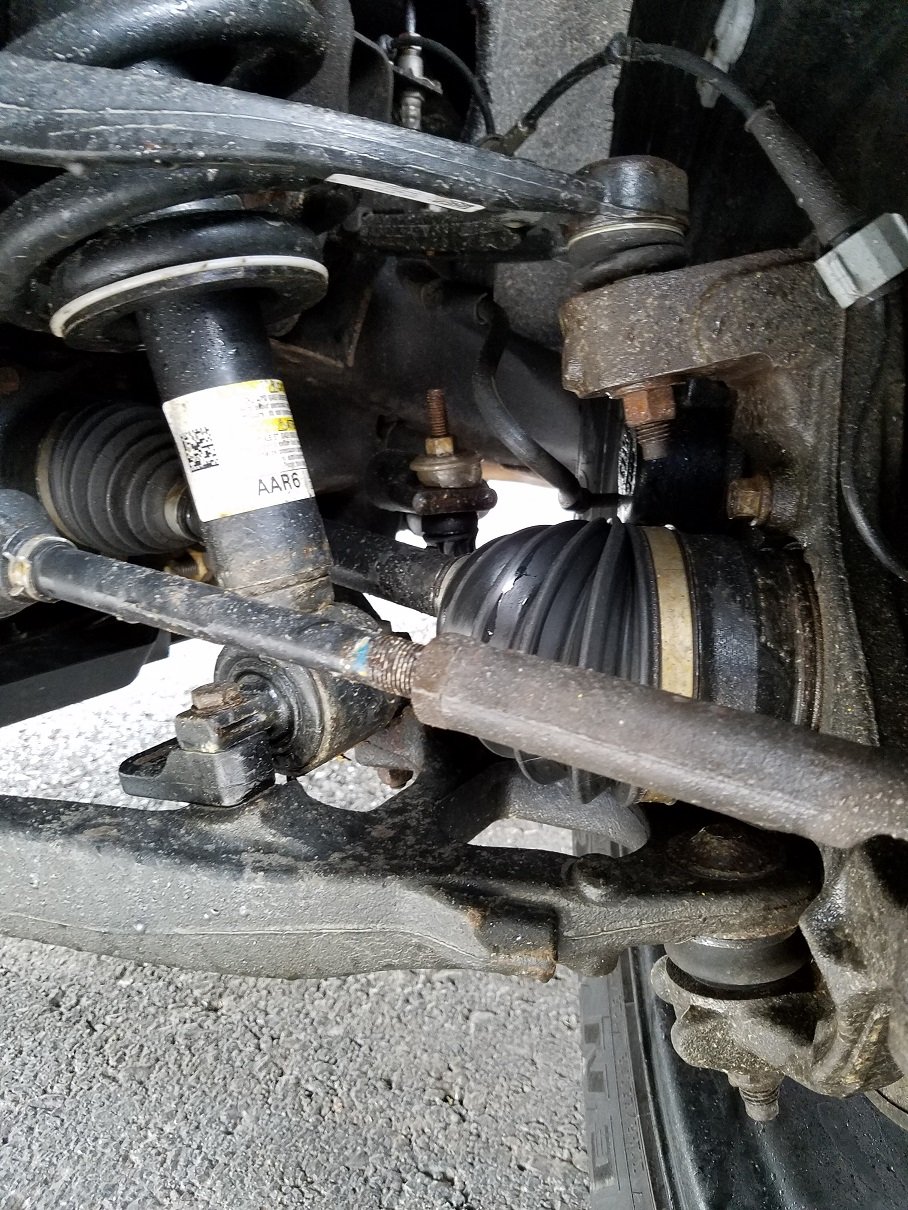

How do my ball joint angles look from those pics I posted?  I was assuming I would have premature wear with having the level kit.
