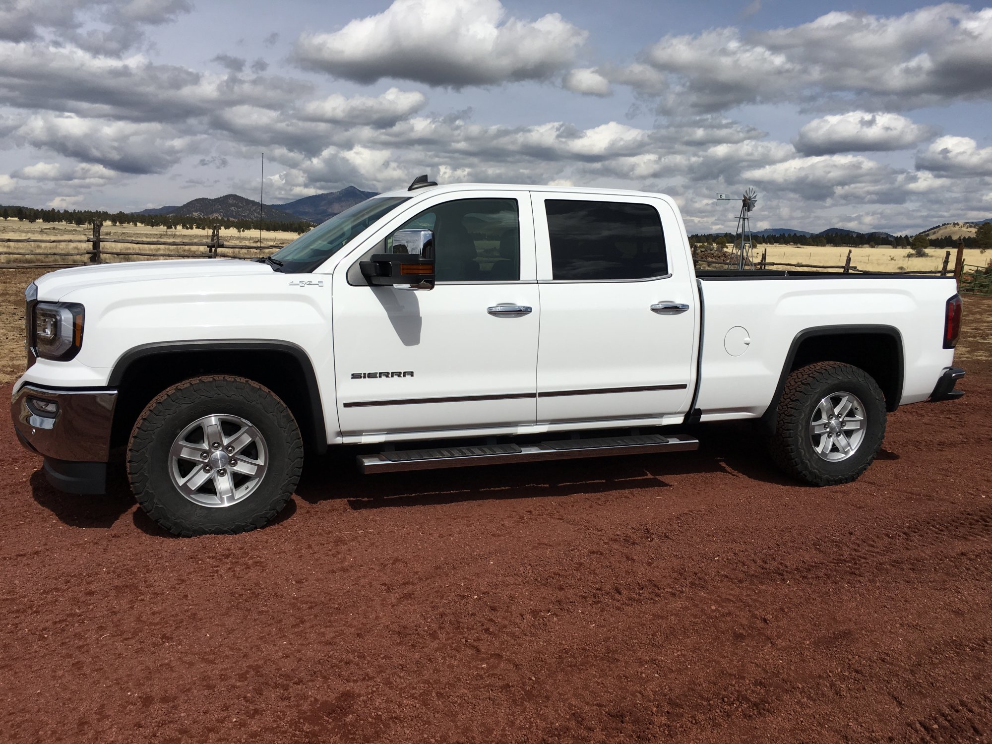

Got my gmt900 wheels put on. 285/75/r17. About 32.7” tall. no rubbing. Lots of room by bumper and rear liner. I can take measurements later if someone wants clearance info. Truck is bone stock.
Speedo is slow 2mph. speedo says 70. Gps says 72. Will that affect much? Not sure if my dealer will adjust.
FYI I had tire shop put on the stick on weights that go on inside of wheel. There is only room for 1 layer of stick on weights because 2 layers will not clear caliper.
Not quite sure why you went down to the 17s, but looks good.  I also liked the chrome stock wheels.  Did you get the bilstiens on, or did they fit without them?

Fit without them.
Bilstiens on order. I already had these wheels and tires. I didn’t like the chrome clad 20” wheels. Tire shop also chipped the chrome clad by valve stem when moving sensors to other wheels. Found out the SLT premium plus 20” is really an aluminum wheel with a PLASTIC cover with chrome paint? Layer. Ridiculous! One curb rash must just destroy these. And this is a premium wheel? LOL

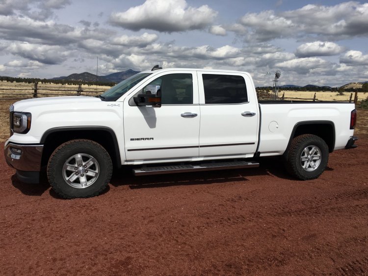

Looks like your new tires are 4.8% larger in circumference and diameter. Looks on the site "Tire Comparison" and put in your stock size and the new tire size and it will show you the difference.
So your speed will be off 4.8% at all speeds not just a "general" 2 mph.
