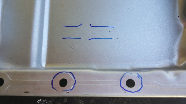

Where you want pay attention to primarily is around the bolt holes. If someone overtorqued them then they could be mushroomed somewhat and need to be flattened out. See the attached picture. Note my crude drawing in the pan. :)

Where you want pay attention to primarily is around the bolt holes. If someone overtorqued them then they could be mushroomed somewhat and need to be flattened out. See the attached picture. Note my crude drawing in the pan. [emoji4]

Thank you for the information. It makes perfect sense. However, the factory differential cover isn’t flat on the gasket sealing surface due to some indentations between the bolt holes. It may not be easy to straighten out. Would it just be easier to replace the cover? My fear is that if I mess with it and it leaks, I’ll be changing the oil for a 5th time instead of 4th.
Yep would be easy to replace the cover, if you on't feel comfortable straightening cover. Cost is $20 - $30
