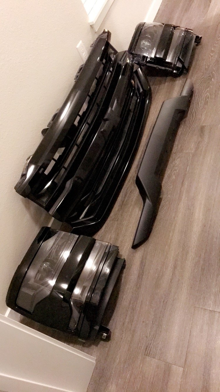

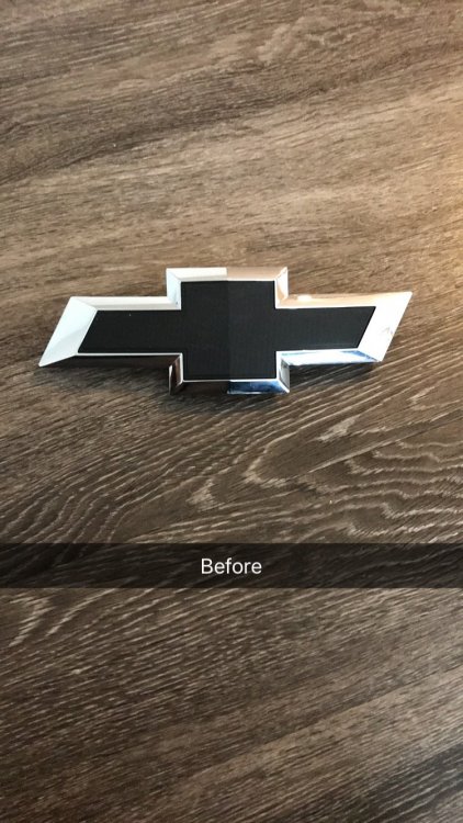

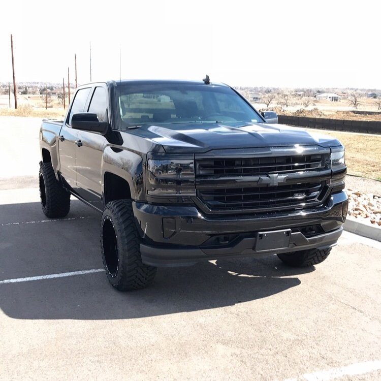

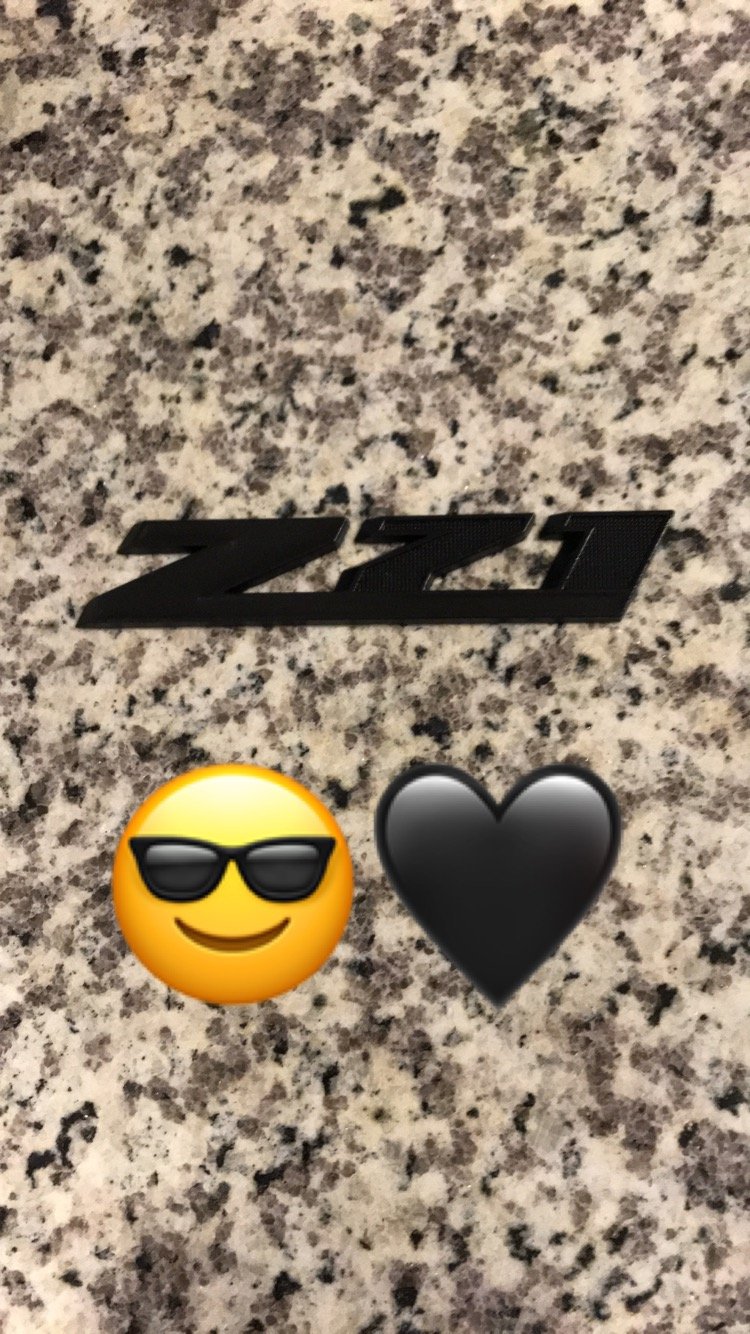

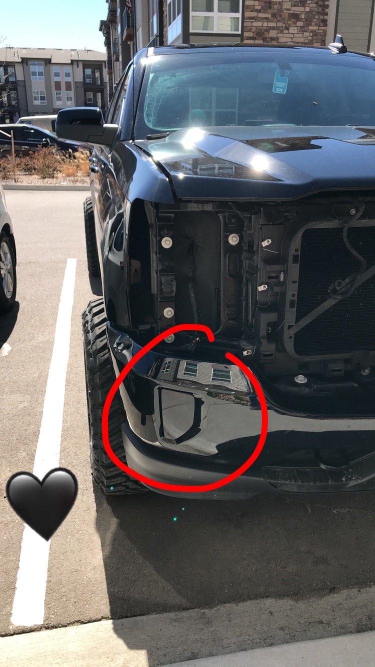

Blacked out my whole front end this weekend. Have a separate post for my headlights. Used platidip on my bowtie, Z71 emblem, and chrome bumper valance/skid plate/mustache. Used VHT nightshade on my fog lights.
Why did you let your girlfriend/wife/sister post the pictures? She added a little heart to the pics, no way a guy did that...
Not bad, I am not one for the blacked out cali look but I like how you took the time and did the headlights right, rather than just thrown some night shades over them.

Second - how hard was it to remove the mustache? I was looking to paint mine this summer but was going to try to do it while it was still attached...

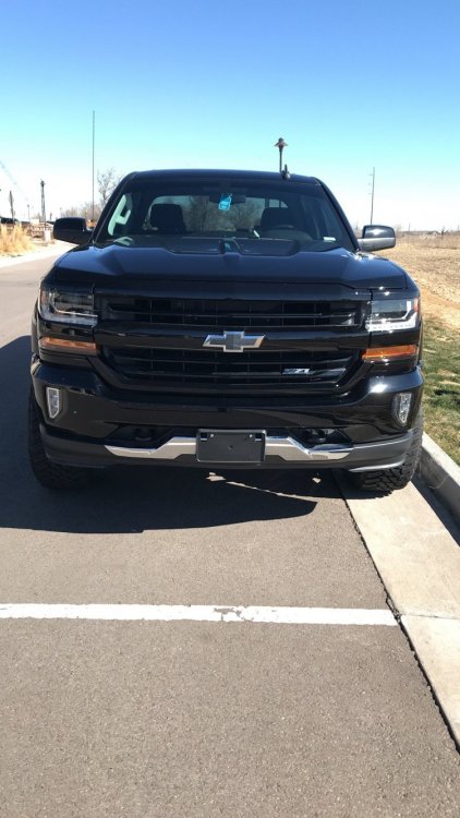

I second that question. Also, did you happen to snap a picture with the chrome skid plate removed? I’m interested to see what it would look like if I just took it off.

Removing the mustache was simple. Just climb under your bumper and you'll see like 20 plastic tabs. Easy to get to. The bottom 2 corners have a metal retainer clip, but other than that just plastic clips. Pretty straightforward.
WENT ONLINE TO BLACKOUT MY BOW TIES, THE DEALER JOBS ARE BIG BUCKS. Even online they were 65.00 each,
then I found some overlays for 6.99 a set, and they worked great ! you need to take your time, and go around the edges with a razor knife . Also be sure the plastic ones are super clean, I used window cleaner , then alcohol.
The center of mine was already black so I just hit the chrome outline with Plastidip. It's held up to several car washes and a snow storm thus far.

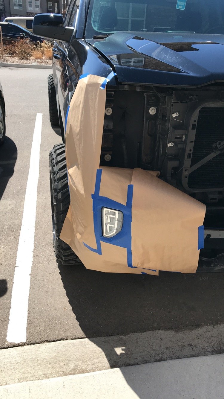

Change the brightness of your lights any?
Made my fogs essentially useless, which I was prepared for. I didn't want to remove my bumper to get to the fogs so I could take them apart to paint the chrome housing, so I just smoked the entire exterior lense. My headlights are exactly the same since I didn't touch them. Only smoked the clear lense over the driving lights, the amber lense over the turn signals, and the amber corner markers... the exterior cover for the entire light assembly is still clear.
