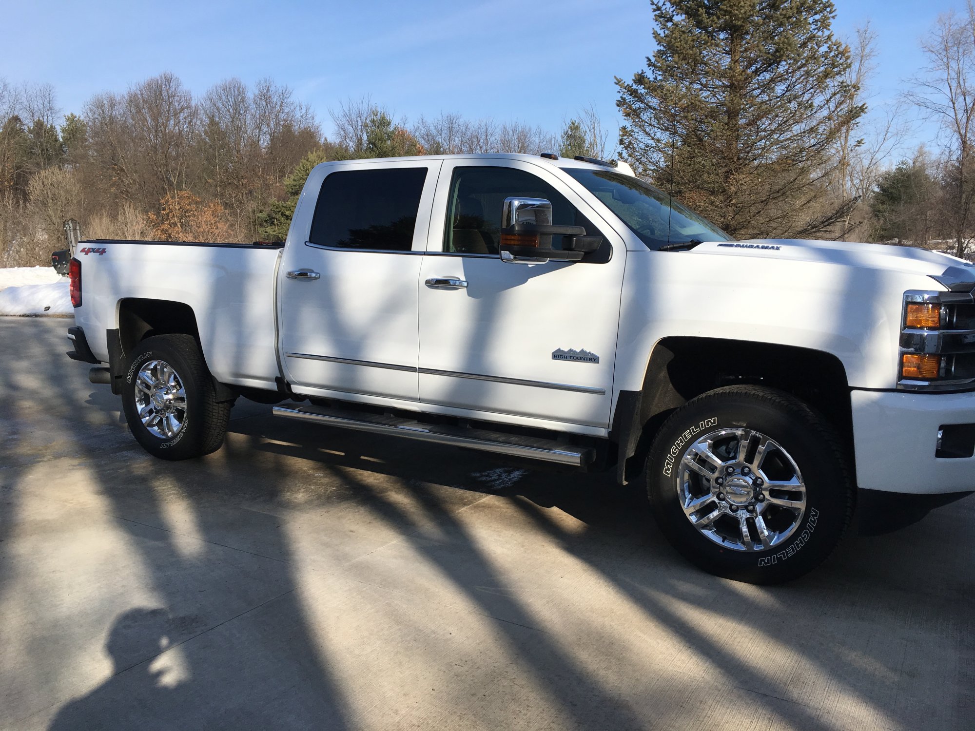

I have a leveled 2500. I use factory wheels on 275/65-20 tires. No rubbing.08be2ca8ae6d47ec951a5bbcded759b8.jpg

Stock 2500HD like in my picture are 20x8.5 +44 offset

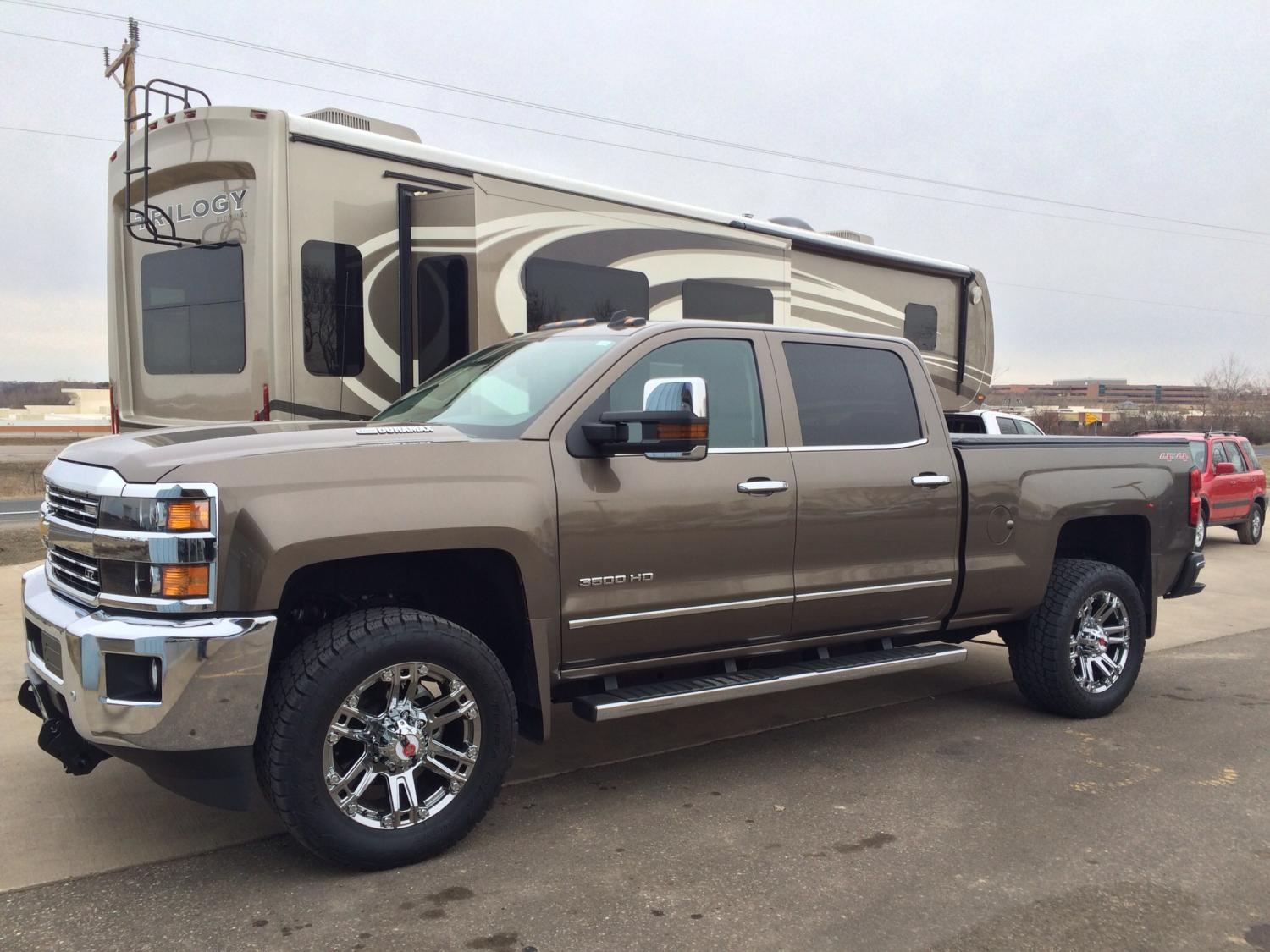

I had 20x9 +1 rims on my 2017 High Country with a leveling kit.  Biggest tire I could fit was a 285/55/20 that I thought looked too small.  I took off those rims and went back to the factory 20’s.  I put 275/65/20’s on the factory rims.  Personally I think the best look is 305/55/20 on a +18-+25 offset wheel.   I just can’t blow any more money on my wheel and tire addiction.  The 305’s on +20 will clear just fine
Here is a pic of 305/55/20 on 20x9 +25 Worx wheels I had on my previous 2015 3500
