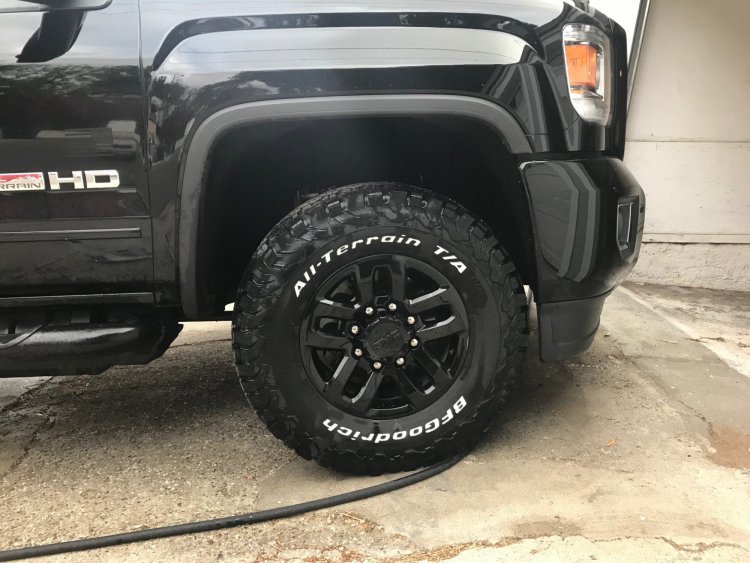

One thing to note, the 275/65R20 BFG KO2's seem extremely narrow in my opinion.  Anyone else notice this?  I have some on +18 20X9 wheels and I'm not crazy about it.
I had some 305/55R20 Cooper STT mounted on them last year and I hated the road noise and I went back to stock wheels and the BFGs (sold the Coopers)  This setup looked ok but it did rub the front fenderwell material I believe in the front of the passenger side on a tight left hand turn.
I'm sure they are. BFG's are notorious for running on the narrow, and the 275 is a narrow size anyway...especially for a 34" tall tire. I've always thought 275/70/18 BFG's looked too narrow too.

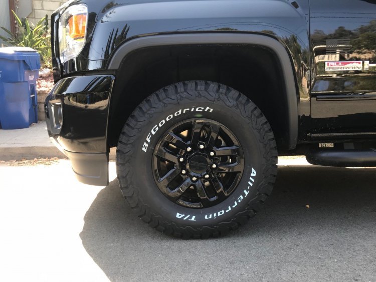

Finally!  The wheels came in last Friday, but I waited until today to have my good buddy that works at the shop complete the install.  We pulled the stock sensors from my original wheels and moved them to the new ones.  I don't have as much rub as it initially looked like I would.  I'm really happy that I went with the 285/65/20 tires.  They are the perfect size and the +20 wheel puts the wheels/tires are just the right spot - the treads are pretty much flush with the fender edges.
Here are the pictures!
Before:
After:

Nice! How are your tires pretty quiet?
Thanks!
I love these tires.  I had them in a 295/60/20 on my 1500 and didn't even consider a different tire this time around.  Good road manners, look good, two different shoulder patterns to choose from, do well in snow, etc.  And yes, quiet.
My work commute is about 85 miles round trip, pretty much all highway.  I wouldn't even consider something else at this point.

Looks great! Very nice upgrade! I like the 285/65/20 size. It's a nice way to get a 35" tall tire without having to go to a true, 35x12.50x20.
...which is a PITA unless you go high.
Looking very sharp.

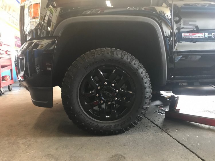

For reference I'm running 35x12.5x18 on stock wheels / no other modifications. I have a slight rub at the very end of full lock, but I tend to avoid the last inch of full lock. It must be the 18' offset or simply everyone avoided trying to mount these on stock 2500 and assume they rub elsewhere.
35's
after.thumb.jpg.2aa319e79103cf47d3eaa2a8d5e2ef1d.jpg.a7d7715bd9decd095b97c311930adb82.jpg
Wheels turned to the point of minimum clearance (9 o'clock to the left / right on steering wheel) still has 1 inch of clearance.
