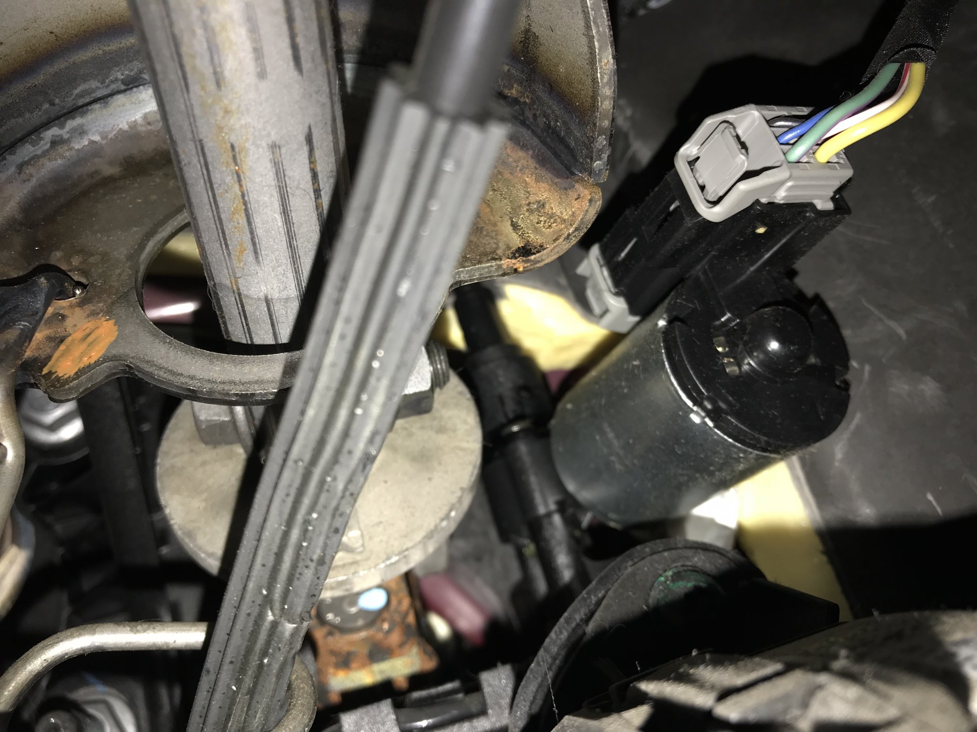

Hey guys/gals,
I am working on integrating Seat Memory and was wondering if anyone who has a Seat Memory Truck with adjustable brake/gas pedals, can snap some pics of me please.  I need to see the motor that moves the pedals in/out.  The motor is mounted behind/above the gas pedal.  Looks like this.

Here you go phill…let me know if you need more

Thank you! The schematics I’ve got show the motor with an additional input connector that feeds a position sensor. The motor you’ve got looks identical. I don’t see another connector on yours. I wonder if it’s on the back side :(.
Looks like your harness goes to the right while mine goes up and to the left.
Thank you! The schematics I’ve got show the motor with an additional input connector that feeds a position sensor. The motor you’ve got looks identical. I don’t see another connector on yours. I wonder if it’s on the back side [emoji20].
I will take another look...if I see another connector I will send you a picture of it
I don’t see another connector on the back side of motor…I pushed the mat back and did not see anything. Does the other connector look like the one on the motor?
They look the same. Can you let me know what the part # is to yours?

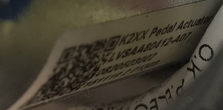

This is mine.
And lastly, do your pedals revert back to a stored memory location upon recall?
On my 2015.5, the pedals do revert back to stored memory location upon recall.

Thanks! If you have pics of part #s, that’ll be great. Seat Memory Integration is done. I can adjust my pedals but can’t get them to revert to a stored position upon recall.
This is mine.
I will try to get that tomorrow for you
A little hard to get in there, hope this helps. Here ya go...
